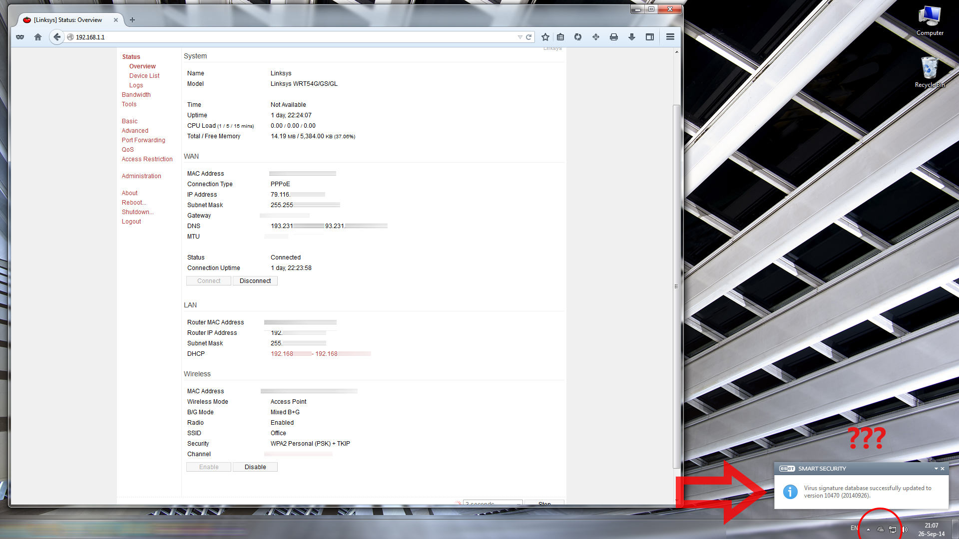

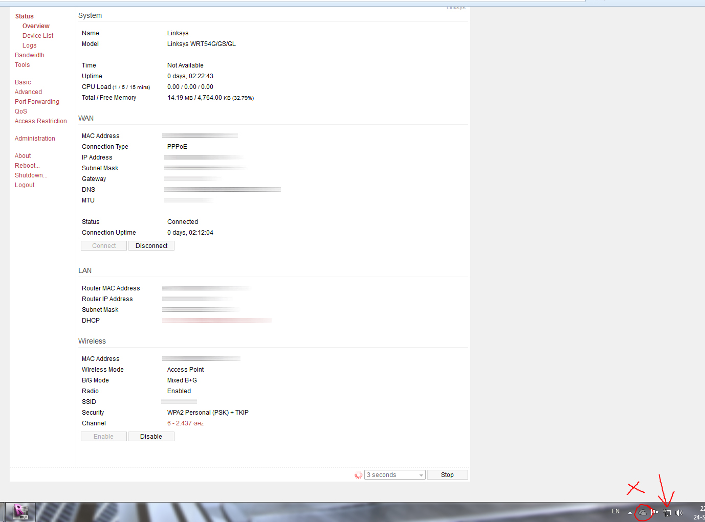

Well.. here it is.. I can access it's interface.. all seems fine there. The wierd thing is that the icon show's connected even no traffic available (one drive cannot syncronize).

what Icon shows connected - your OS icon.. that just says you connected to the router, if it says limited means it couldn't talk to the internet or dns is not working, etc. Was not able to see your image.
So status shows you good for internet on the router? If the reboot is not working on the gui - just pull the power plug on it, and then plug it back in.
So says your connected to isp, how do you know its not a isp issue? Have you connected something else other than the router and that works? What is before this router? Are you natting or bridging on that device? You have it setup for PPPoE, and shows connected.. Have you called your ISP?

Well that picture is USELESS, and most every dsl "modem" I have seen in the last 10 years does NAT.. You have it set for PPPoE, this makes me think dsl type connection.
So I find it pretty likely its doing nat. You blocked out every piece of info in your screen shot of your router status that would of given this info.

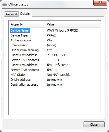

- now I've connected the pc to the modem. and here are the details..

So you are setting up PPPoE on the client you connect.. what does a tracert look like to 8.8.8.8 from the client that works?
Then try and ping hop 2 or 3 in that trace from your router. Power cycle your isp device, wait til it fully comes back. Then connect your wrt and turn it on - let it fully come up and connect a client to it and try and ping and trace to that same IP.. What do you get?
well that sure looks like you have internet to me - you ping googledns with you router - so what is not working??
Its odd that you have rfc1918 addresses in the path.. But you clearly are on the internet and can get out with that router.
