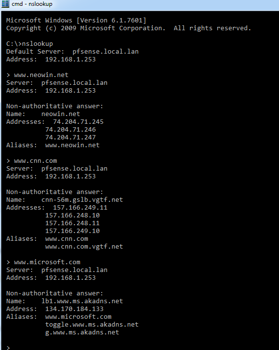

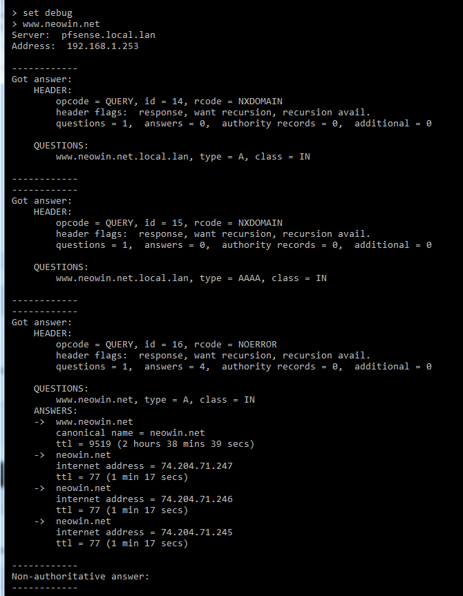

+BudMan MVC Posted September 28, 2014 MVC Share Posted September 28, 2014 So what do you want me to get from that? That is clearly not the full trace.. Did you get an answer or not? only set debug when you don't get an answer.. set your server to something else than your router.. say 8.8.8.8 C:\>nslookup Default Server: pfsense.local.lan Address: 192.168.1.253 > server 8.8.8.8 Default Server: google-public-dns-a.google.com Address: 8.8.8.8 > www.neowin.net Server: google-public-dns-a.google.com Address: 8.8.8.8 Non-authoritative answer: Name: neowin.net Addresses: 74.204.71.246 74.204.71.247 74.204.71.245 Aliases: www.neowin.net Just copy and paste the full text if your going to do debug.. I can not make heads or tails of your pic.. Since all your showing me is the root servers which would first part of the trace.. Where is your got answer section?? Where is your question section?? Link to comment https://www.neowin.net/forum/topic/1230655-linksys-wrt54gl-tomato-127-firmware-issues/page/2/#findComment-596594527 Share on other sites More sharing options...

+BudMan MVC Posted September 29, 2014 MVC Share Posted September 29, 2014 as I showed in my post C:\>nslookup Default Server: pfsense.local.lan Address: 192.168.1.253 > server 8.8.8.8 Default Server: google-public-dns-a.google.com Address: 8.8.8.8 Link to comment https://www.neowin.net/forum/topic/1230655-linksys-wrt54gl-tomato-127-firmware-issues/page/2/#findComment-596595591 Share on other sites More sharing options...
Cosmin Posted September 29, 2014 Author Share Posted September 29, 2014 can't get more than this.. hope it's ok.. :/ Link to comment https://www.neowin.net/forum/topic/1230655-linksys-wrt54gl-tomato-127-firmware-issues/page/2/#findComment-596595655 Share on other sites More sharing options...
+BudMan MVC Posted September 29, 2014 MVC Share Posted September 29, 2014 what you running these commands on that gives you root servers? never seen nslookup do that.. Windows what? you resolved it to the right IPs. Well dns is working there.. Does it not work when pointing to your router? Link to comment https://www.neowin.net/forum/topic/1230655-linksys-wrt54gl-tomato-127-firmware-issues/page/2/#findComment-596595665 Share on other sites More sharing options...

+BudMan MVC Posted September 29, 2014 MVC Share Posted September 29, 2014 no no - when you do nslookup, where does it default to point to your routers local IP 192.168.1.1? Does that not work looking up stuff like www.neowin.net, www.cnn.com, www.google.com, www.yahoo.com, etc. Link to comment https://www.neowin.net/forum/topic/1230655-linksys-wrt54gl-tomato-127-firmware-issues/page/2/#findComment-596595693 Share on other sites More sharing options...

+BudMan MVC Posted October 1, 2014 MVC Share Posted October 1, 2014 when you do nslookup what does it ask for dns?? looks to me from your screenshot its 192.168.1.1, this is your router right.. Can you do nslookup for www.google.com from there, does that resolve? It clearly works when you changed server to 8.8.8.8 If that resolves - there there is nothing wrong with your internet, and nothing wrong with name resolution - so you have something else to look at. Link to comment https://www.neowin.net/forum/topic/1230655-linksys-wrt54gl-tomato-127-firmware-issues/page/2/#findComment-596598649 Share on other sites More sharing options...
Cosmin Posted October 1, 2014 Author Share Posted October 1, 2014 when I write nslookup and press enter automatically appear next 2 rows.. Can you do nslookup for www.google.com from there, does that resolve? simmilar as I've did with "www.neowin.net" I quess ? & if succeeded.. there should be something with settings on tomato firmware.. should I upgrade to latest version 1.28 ? Link to comment https://www.neowin.net/forum/topic/1230655-linksys-wrt54gl-tomato-127-firmware-issues/page/2/#findComment-596598685 Share on other sites More sharing options...
