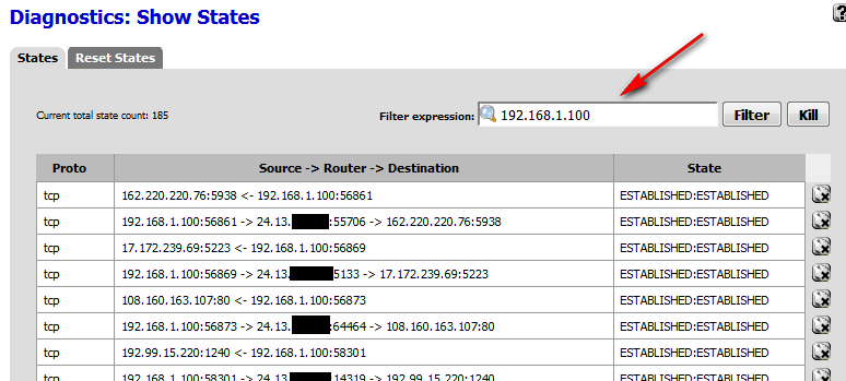

Does your router show you the state table? If so you could find where the device is going in there..
example
If it was me - I would pick up a cheap smart switch that does span ports, return it when done with the sniff ;) Bridge 2 interfaces on your PC, pick up 2nd nic if need be. If your PC has 2 nics -- cheap nics can be had for like $5-10. You could then sniff and know exactly what the device is doing.
Once you have the IPs the thing is going to, then you can see who owns them and give your IT guys the netblocks vs the IP.. So lets pick for example that IP on my state table.
162.220.220.76:5938 <- 192.168.1.100:56861
If I do a whois for 162.220.220.76
NetRange: 162.220.220.0 - 162.220.223.255
CIDR: 162.220.220.0/22
NetName: ANEXIA-US
I would give the IT guys hey need port 5938 tcp to 162.220.220.0/22
If anyone is curious what that connection is, that is teamviewer.
And so and for your other IPs it connects too - they might all be in 1 block, they might be different. The NTP is most likely just uses a pool, which is going to be pretty much impossible to find IPs - because ntp pools change all the time. Pretty much every time you query them. But they could do it the other way around, and vs letting the whole network go to any NTP server on the internet, they could let this devices IP only go to any ntp server.
