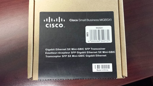

I have a new question now.  I read up on SFP+ and I think I understand what it does.  If I want to use a fiber cable, then I plug a fiber module into the SFP+ port.  If I want to use a RJ45 cable, then I plug a RJ45 module into the SFP+ port.  Interesting technology.
I was on NewEgg on this page.  http://www.newegg.com/Wired-Networking/Category/ID-40
There are two categories that I'm confused about: "switch modules" and "network transceivers".  I checked the two links, and they seem to offer the same thing.  What is the difference between the two categories?
Yes a SFP would allow you to put whatever type of module you want in, be it fiber or copper. The sg300 ports 9 and 10 are combo, they already have rj45 copper connection so you don't need anything else if you just want to use copper.
SFP stands for (small form-factor pluggable) "transceiver" so not sure where the confusion is?
The old way was GBIC, but you would plug the transceiver into the SFP port
