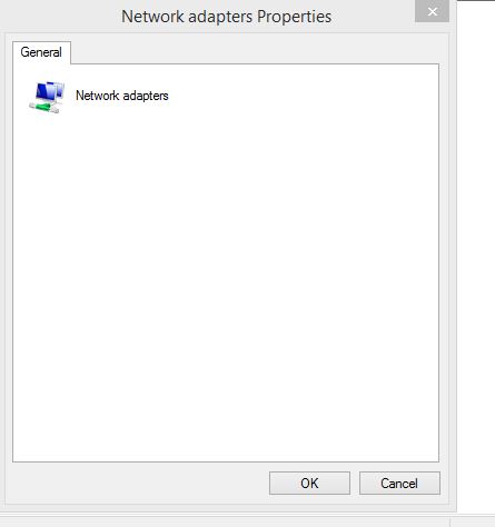

Circaflex Posted November 15, 2014 Share Posted November 15, 2014 Stay away from those "drive programs" they cause more harm than good. Go to HPs website, enter your model, download all drivers for windows 8 on a USB drive. Clean install then use the usb drive to install the different drivers. Otherwise, open devmgmt.msc right click your network adapter, select properties then details, then hardware id copy the string to google and search for a true Windows 8.1 driver. Download and save it to USB then do the same for any other device that was not automatically installed when performing a clean install. What is your computers model and I can help Link to comment https://www.neowin.net/forum/topic/1236811-how-to-back-up-my-windows-81-drivers/#findComment-596652301 Share on other sites More sharing options...

Dane Posted November 16, 2014 Author Share Posted November 16, 2014 Stay away from those "drive programs" they cause more harm than good. Go to HPs website, enter your model, download all drivers for windows 8 on a USB drive. Clean install then use the usb drive to install the different drivers. Otherwise, open devmgmt.msc right click your network adapter, select properties then details, then hardware id copy the string to google and search for a true Windows 8.1 driver. Download and save it to USB then do the same for any other device that was not automatically installed when performing a clean install. What is your computers model and I can help Thanks, HP ENVY 700. Model 700-010xt. Going to HP's website, http://h10025.www1.hp.com/ewfrf/wc/softwareCategory?os=4132&lc=en&cc=us&dlc=en&sw_lang=&product=5362530#N4383 That has the list of drivers and whatnot. When I did the fresh install, I went to the device manager, and there was nothing under the Network Adapters. There was no yellow warning signs or whatnot. The two that show up on their site is a "Broadcom Wireless Network Controller Driver2013-04-30 , Version6.30.59.139 Rev. A," and "Atheros Network Controller Driver2013-05-22 , Version2.1.0.13 Rev. A," I downloaded both of them and tried, and got the same warning: "doesn't meet the requirements." So now however, with the recovery image. it shows this: So I really have no idea what the issue was. Also right clicking on the network adapter and clicking properties doesn't show much. Link to comment https://www.neowin.net/forum/topic/1236811-how-to-back-up-my-windows-81-drivers/#findComment-596653315 Share on other sites More sharing options...
Gotenks98 Posted November 16, 2014 Share Posted November 16, 2014 You are not right clicking on the individual adapters and viewing the properies thats why it does not show anything. Also like the others have said the driver backup programs do more harm than good and often are just malware. You come out better downloading them ahead of time from the manufacturer's site. Also keep in mind if you have Broadcom for wireless you might have issues connecting to enterprise networks unless you use a windows 8.0 drive instead of the 8.1 driver. Link to comment https://www.neowin.net/forum/topic/1236811-how-to-back-up-my-windows-81-drivers/#findComment-596653325 Share on other sites More sharing options...
Dane Posted November 16, 2014 Author Share Posted November 16, 2014 You are not right clicking on the individual adapters and viewing the properies thats why it does not show anything. Also like the others have said the driver backup programs do more harm than good and often are just malware. You come out better downloading them ahead of time from the manufacturer's site. Also keep in mind if you have Broadcom for wireless you might have issues connecting to enterprise networks unless you use a windows 8.0 drive instead of the 8.1 driver. Sorry about that. When I did the fresh install, it was an install of Windows 8 64, and the drivers on their site are for Windows 8. I'd install Windows 8, do the drivers, then do windows updates to get to Windows 8.1 I don't need to conect to enterprise networks. Link to comment https://www.neowin.net/forum/topic/1236811-how-to-back-up-my-windows-81-drivers/#findComment-596653367 Share on other sites More sharing options...

Circaflex Posted November 17, 2014 Share Posted November 17, 2014 So is everything good now or you still have internet issues? you actually right click each individual adapter and select properties then youll get a hardware id that you can google for exact drivers Link to comment https://www.neowin.net/forum/topic/1236811-how-to-back-up-my-windows-81-drivers/#findComment-596653777 Share on other sites More sharing options...

Dane Posted November 20, 2014 Author Share Posted November 20, 2014 Doesn't the HP Envy uses driver packages? You should only need the package right for your model. Otherwise you can use DriverMax to export all your drivers. The HP Ralink driver seems to be here. I'll remember that for next time. Thanks! So is everything good now or you still have internet issues? you actually right click each individual adapter and select properties then youll get a hardware id that you can google for exact drivers Everything is good since I am still on the recovery version. I haven't done another clean install yet. There is now a way to skip directly to 8.1. using the 8.0 product key instead of having to do the store upgrade. This will save you a bit of time. Go here for the ISO file. http://windows.microsoft.com/en-us/windows-8/create-reset-refresh-media Ohh I like that! Best way to back up a driver is to put it in reverse. No really, I would just download the latest ones whenever you do a restore but keep a current copy of the installer files in case they aren't available in the future. Thanks. Link to comment https://www.neowin.net/forum/topic/1236811-how-to-back-up-my-windows-81-drivers/#findComment-596657135 Share on other sites More sharing options...
