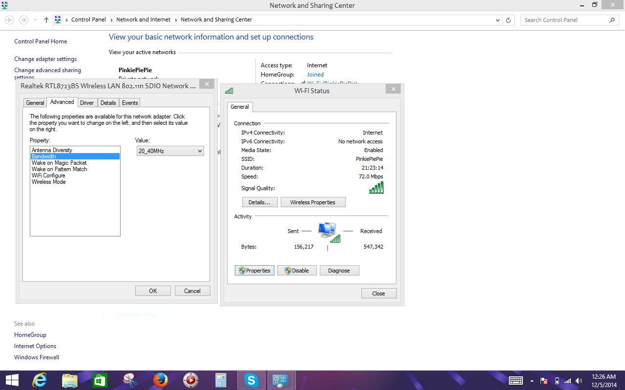

I seem to be experiencing a similar problem with the E Fun Nextbook 8 Windows 8.1 tablet. I believe it uses a similar, if not identical chipset to the Stream 7. My router is a Linksys E800. Temporarily, I've connected the Nextbook tablet to another access point that has no other devices connected.
20 or 40Mhz mode?
You may also have to turn this on:
Also when I have "antenna diversity" ticked on I have a lot less "retries" as well:
(Note the times present by aruba's instant controller config url)
