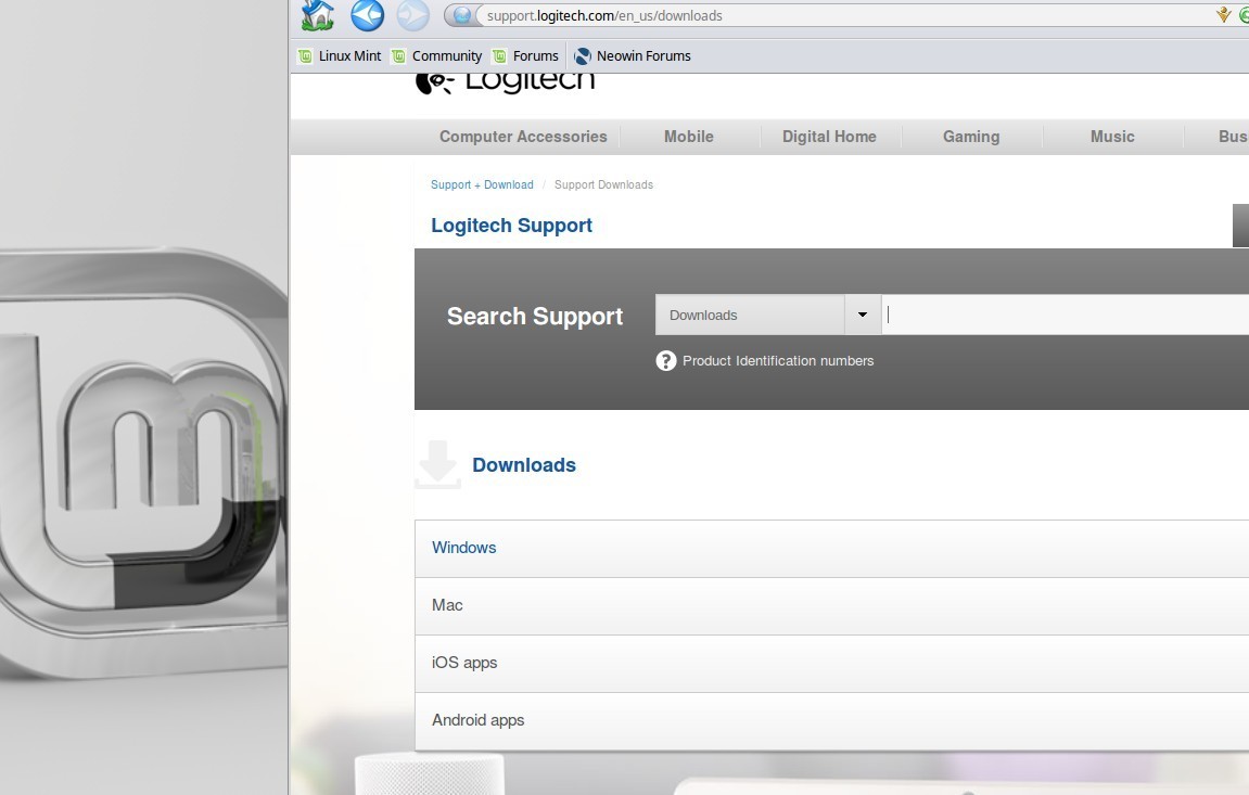

T3X4S Posted January 8, 2015 Share Posted January 8, 2015 Running mint 17.1 w/ KACE in VMWare I would like to be able to use the forward and backward side buttons on my Logitech Performance MX Is there a way to do this ? No help from Logitech apparently: I did the Software Manager thing and didnt see anything that would help. I dont think this is a VMWare thing as I am running win10 in VMWare as well - and of course there is no problem there... Thanks Link to comment Share on other sites More sharing options...

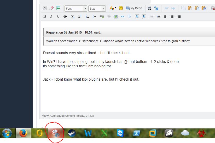

T3X4S Posted January 10, 2015 Author Share Posted January 10, 2015 Wouldn`t Accecsories -> Screenshot -> Choose whole screen / active windows / Area to grab suffice? Doesnt sounds very streamlined... but I'll check it out. In Win7 I have the snipping tool in my launch bar @ that bottom - 1-2 clicks & done Its something like this that I am hoping for. Jack - I dont know what kipi plugins are, but I'll check it out. Link to comment Share on other sites More sharing options...
simonlang Posted January 10, 2015 Share Posted January 10, 2015 Doesnt sounds very streamlined... but I'll check it out. In Win7 I have the snipping tool in my launch bar @ that bottom - 1-2 clicks & done Its something like this that I am hoping for. Capture.JPG Jack - I dont know what kipi plugins are, but I'll check it out. sudo apt-get install ksnapshot kipi-plugins after installed forget about navigating through endless entries in the startmenu. you just press the print button on your keyboard and up comes a very nice interface with the screenshot already done + lots of options to send/upload your screenshots directly. i mostly use the export to imgur function. T3X4S 1 Share Link to comment Share on other sites More sharing options...
