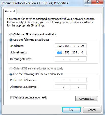

+BudMan MVC Posted February 16, 2015 MVC Share Posted February 16, 2015 well on windows go to your interface and change from dhcp to static and put in and IP address on 192.168.0.x that does not conflict with camera IP you want to connect to. Then use netmask of 255.255.255.0 Done. Like this Once done just change to dhcp again. Link to comment Share on other sites More sharing options...
