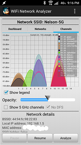

I did a wireless site survey today and I have roughly every channel overlapping at one point or another by the wireless networks in my local zone.  I did try Channel 8 seeing that was open, but had no improvement.   (84 unit Apartment complex with about 8 units per building) (our SSID is Nelson and Nelson-5G)

Get off 2.4Ghz if you can and switch to 5Ghz, if you can't then try using only channel 1, 6 or 11. The way WiFi works, it doesn't really care about fully overlapping signals (i.e. 3 APs on the same channel) because it can detect they're wifi signals and work around them, but partially overlapping channels just cause noise, which reduces the signal quality.
Also, unless you're using pure N/AC on 5Ghz with the right antennas, you just aren't going to get great speeds with WiFi. It's main benefit is portability, not connection quality.
You have "Nelson" and "Nelson-5G", which for the latter I guess is intended to be for 5GHz WiFi, but you aren't using the 5GHz channels (channels 1 to 13 are 2.4GHz) in the screenshots. 2.4GHz is pretty much congested everywhere, not much you can do about it - try to see if you can use the 5GHz channels on your devices. Also note that switching to channel 8 doesn't bring much of an improvement because, as the Wifi Analyzer app that you are using shows, the wifi signals do actually "spillover" to the neighboring channels, in fact the common practice is that you can only use channels 1, 6 and 11 without the channels interfering with each other. Unfortunately, a quick google search seems to say that the Actiontec is a 2.4GHz only device... while your Netgear R6100 is a pretty high-end router.
