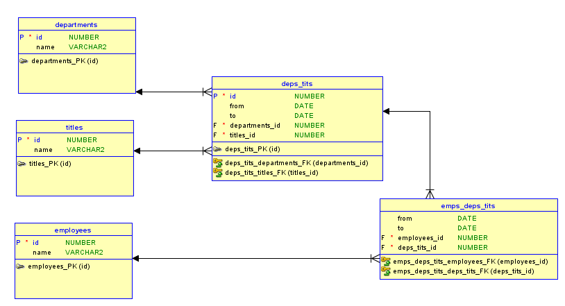

To answer shortly, you could create a DEPARTMENTS table and a TITLES table and then create two more tables: EMPS_DEPS and EMPS_TITLES. Can you figure it out by yourself from here?

1. You'd create DEPARTMENTS for your business.
2. You'd come up with TITLES for your business.
3. You'd assign titles per departments: DEPS_TITS.
4. You'd hire EMPLOYEES.
5. You'd assign them to departments and give them titles: EMPS_DEPS_TITS. In time...
I'm not sure I understand the division you've made in the graph, I'd create 5 tables out of 1?...
  • 0
Yes. It's about the atomicity of the employee data.
Ask yourself this: what happens if an employee changes title or if an employee changes department or if an employee changes both title and department?
The way you've normalized the tables it only accounts for a single change in department and title for an employee.
The way I've done it, it doesn't matter how many changes there are, they're all accounted for.
The first normalization is not explicit about the changes in title and department for an employee. It requires additional work, a perfect candidate for views or stored procedures.
The second normalization is about classifying the titles inside departments as well and, as such, it's explicit about the correlated department-title changes.
