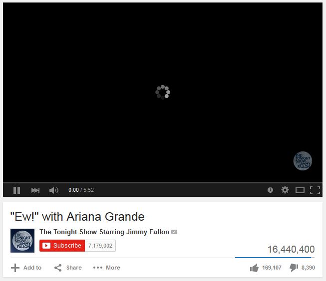

When I click on a video, I get the white-ish grey circles rotating, but it never stops, and the video never starts.  If I hover over the placemarker to advance somewhere in the video, I see the little thumbnail over the placemarker, but when I click Start - nothing happens.

Yep, it's YouTube's way of saying "What is wrong with you? Why are you watching Ariana Grande stuff?"  :laugh:
I was wondering if someone was going to comment on that - it was on my main page - I like the Jimmy Fallon stuff ;)
