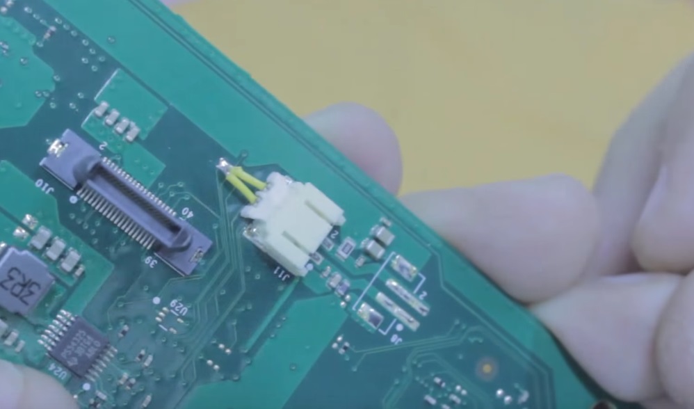

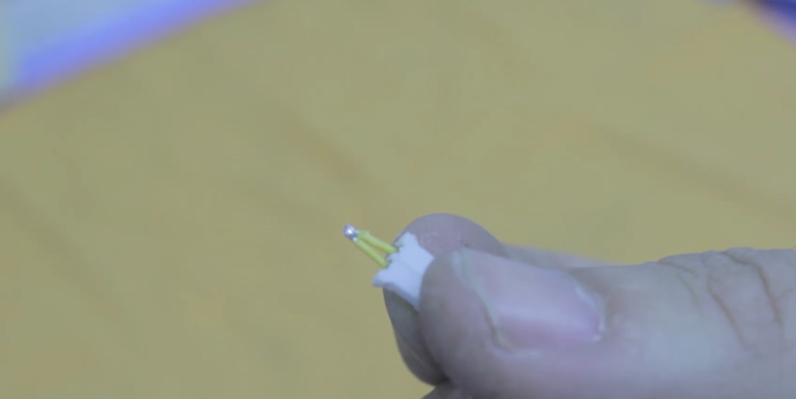

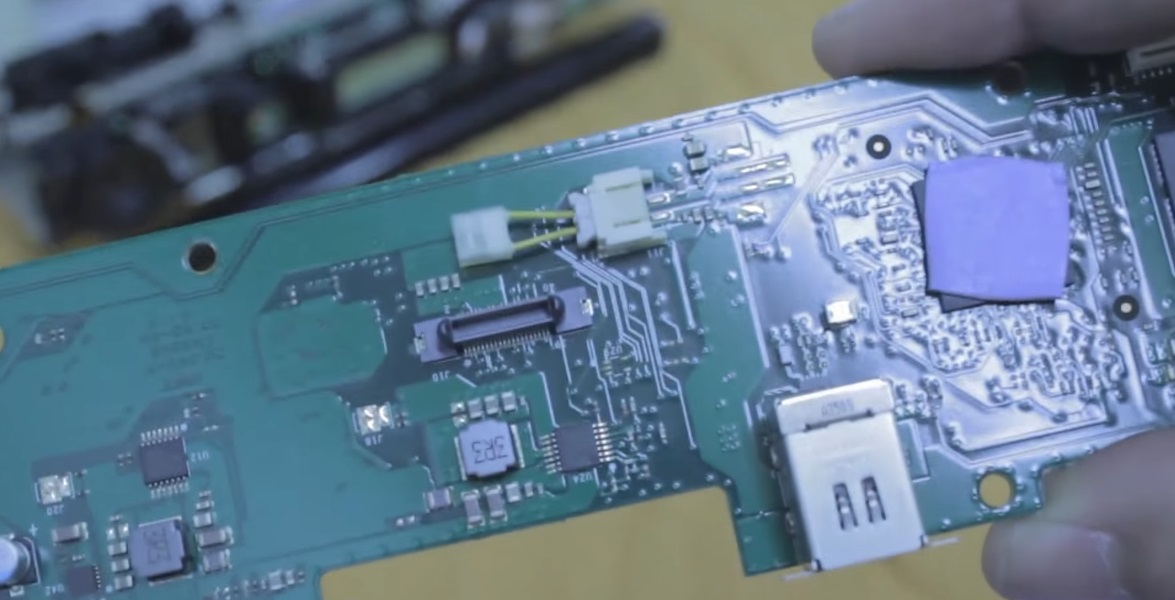

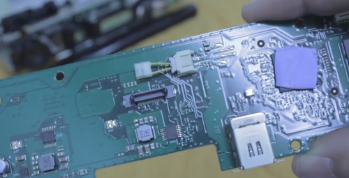

Hey everyone! So...as I mentioned...I had my XBONE Kinect working in March...guess what...quit working again...go figure. I now have it working again....here is the new plan of action. Mind you...if you attempt this fix you will need a bit of soldering and understanding of mechanical working knowledge. I hold no responsibility if you attempt this fix and it does not work or causes damage. With that being said...I disassembled my Kinect and found my fan no longer working. I had a small CPU fan that I removed and rewired for use on the Kinect. I did not use the yellow wire on the Kinect...I simply wired the black, red, and blue wires on the fan to the old connector for the bad Kinect fan. Mind you the Kinect fan is 5vdc and the cpu fan is 12vdc, but all seems to be working fine. The fan runs 24/7 now. Due to the larger size of the cpu fan I had to use black duct tape to secure it to the back of the Kinect. No problems anymore and this seems to have taken care of the issue once more. If you have any questions or need to see pictures of the work please feel free to reply and I will get back with you as soon as possible. This is the cheap way to go...and you need some soldering skills to do it. I did find some replacement fans from China for about $15 if you just want to go with a replacement instead (I didn't want to wait a month for it to arrive). Long story short...it's a cooling issue causing these Kinect sensors to fail. Thanks Microsoft!
Thru comes out today and i really want to play it, so i'm thinking of heading down this route. Got plenty of old cpu fans knocking around. Will report back!
Edit: I'm in! The cooling fan is stuck solid. That'll be the issue then :p

Ironically mine went off again once the full update was released. I'm not going to blame the update as i left the back off the Kinect just in case and i can clearly see the new fan is jammed again. Bad solder job on my part me thinks, will have to sort it though as Fru is a lot of fun.
