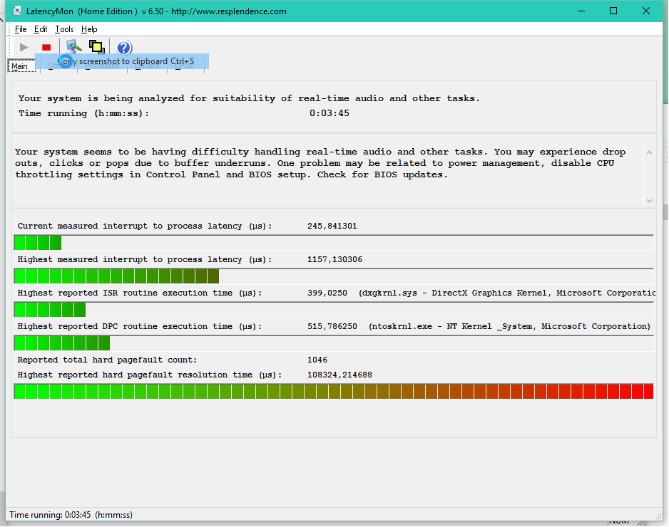

Check if you have latency issues, install LatencyMon.
Start playing a movie and then run the program.

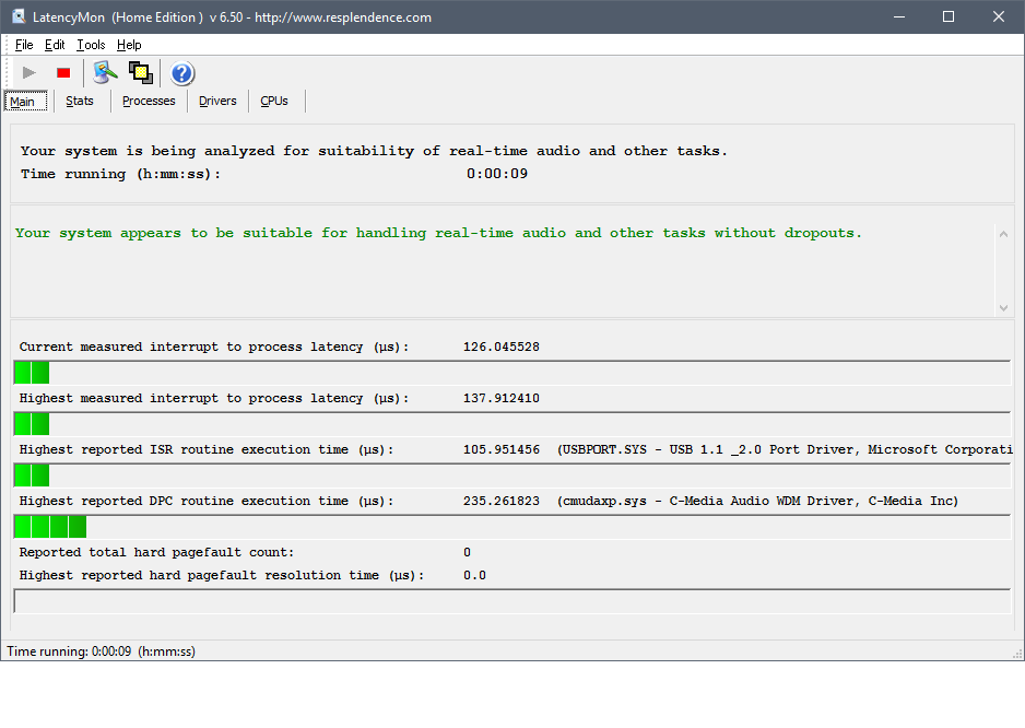

This is mine (Win 10 x64) running MPC-HC 1080p movie.
Latency.thumb.png.eaec95149fef217b9fc7d6
As you can see, the highest is actually the sound card driver "cmudaxp.sys", but it is normal.
