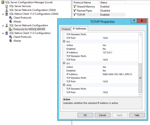

You need to specify port number to be used for tcp it's usually 1433. make sure you set this in the client protocols for tcp/ip
