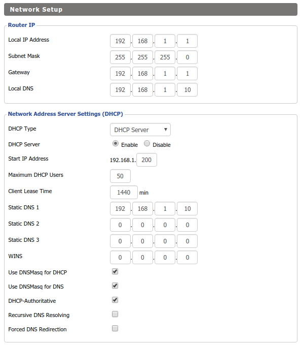

However, I'd like to not have to change the device config, rather get that served from the router. I run DDWRT, and under Router IP settings I've changed the DNS to 192.168.1.10, and also in the DHCP Server settings I've changed it. See below:
Now, DNS works fine across all devices, and they're genuinely using the Pi as their DNS server (can see the requests on the Pi itself). However, I can't access it anymore using the local name. I just get a "Name not resolved" error. I have to browse to it using the IP address instead. Is this some sort of DDWRT quirk, or am I missing something in the setup (likely something basic!)?

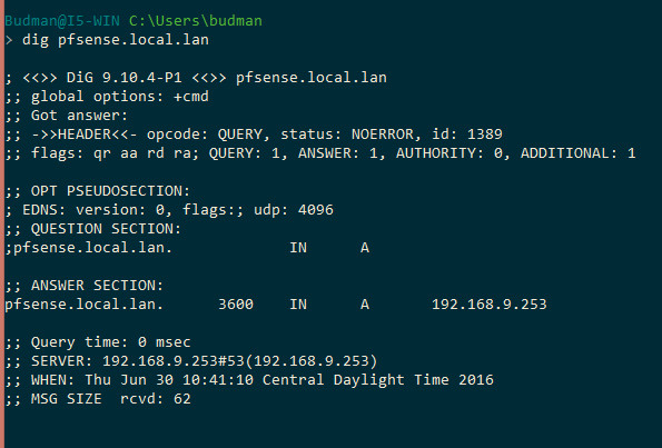

So if I query my pfsense box which is running my dns, which is unbound in resolver mode and I ask it for its own name.. I get a response..
So from here you can see TON of info that would help you troubleshoot your issue.  So you can see what I asked for in the query section, you can see the answer I got back, you can see what server I asked, what the response time was in ms.  You can see the TTL on the record I looked up.  You see the status dns returned back, the flags on the settings for example that recursion was asked for, etc.

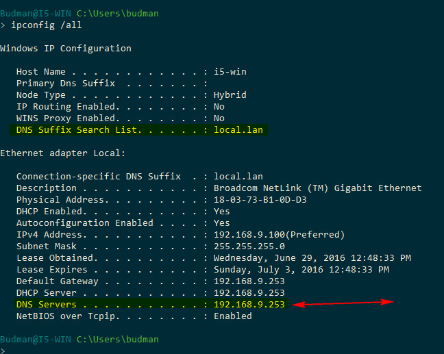

What are you clients actually pointing too for dns?  Simple enough to see with ipconfig /all
So you can see what dns client is pointing too, you see it got IP from dhcp server, you see what search suffix it might be using which could throw off your dns query.

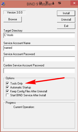

true dig is not native windows, but it takes all of 10 seconds to install and is so much better than nslookup ;)  Grab bind from isc, install just the tools.
https://www.isc.org/downloads/

In your first query that devices is not asking your pi, its asking your dd-wrt.. Maybe it did not update its lease, maybe it has dns set static.. What is the output of its ipconfig /all
I noticed that... it's as though even though the router is told is use the Pi as the DNS server for the local network it's not directly telling connected devices - rather acting as a middleman. Which is what lead me to think it's possibly a router issue - is this something worth asking over on the ddwrt board?
I don't think it being a Pi comes into play at all. It just so happens this software was built in mind for a pi - it can run on most linux distros.
It's the fact devices are showing the router as the DNS server, despite me telling the router to use the Pi address. I can see the live dns requests coming in on the pi from the devices, so clearly it's doing it's job - just the router isn't. When I take the router out of the equation (i.e. use static IP + manually set DNS) everything works as expected.
dude post up your ipconfig /all from this device.. It clearly is not asking your pi so clearly its set to ask your router.  Did it update your lease since you set your dhcp server to point to the pi?

However I did manage to resolve the problem - in ddwrt theres an option in the dhcp setup "Use DNSMasq for DNS".
It's enabled by default, but if you're using an alternative DNS it has to be disabled to point clients directly to the other DNS server - otherwise the router is still a DNS server, just sending it's requests to the other one.
When I did an ipconfig before, the DNS server was listed as 192.168.1.1, now it's listing as 192.168.1.10 as I hoped for.
