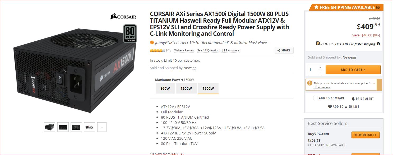

Yes, a PSU is one of the most important factors in a computer.  The reason it is overlooked, and people buy generic ones, is simply because spending more money doesnt make the computer any faster.
But, when a computer is pushed, it draws more power, and if that power is flaky (bad PSU) - nothing good will come from it.  Basically, you'll be lucky if it only fries the PSU and doesnt take a few parts with it.
There are 2 easy ways to spot a good PSU - cost and weight.  (Cheap ones dont have much inside, so they are light)
Some good name brands are :
Corsair
Seasonic
Enermax
There are others, but those are some of the most popular.
The ratings (Bronze, Silver, Gold, Platinum, and Titanium) are another way to know quality. (only a couple have the Titanium rating)
But wattage is only half the story - brand/quality is the other.
A cheap brand will test their PSU in a cold testing facility (electronics fail under heat)
So when a cheap maker tests their PSU and it hits 500W for a split-second, they will slap a 500W sticker on there.
A good brand will stress in real world conditions, and if it hits say.. 520W - they will actually downgrade the rating and put the 500W sticker on there to be safe.
(a cheap 500W PSU - is probably more like a 300W in real world settings)
Right now, the Corsair AX1500i Titanium is one of the best, if not the best on the market. And it should be @ $400.  But most builds dont require something that insane.
Good Luck
16 minutes ago, Hum said:
^ I've seen real world tests on YouTube, which loaded up a PC with high-end componets, and the machine never drew more than 425 watts or so.
Most people do not need 1500 watts.
<snip>
I agree. 1500 watts is never needed. The ONLY time is like when you do a Quad SLI, and overclock like silly.
In a real world, it is not needed. If you just want to show off your system, great.
