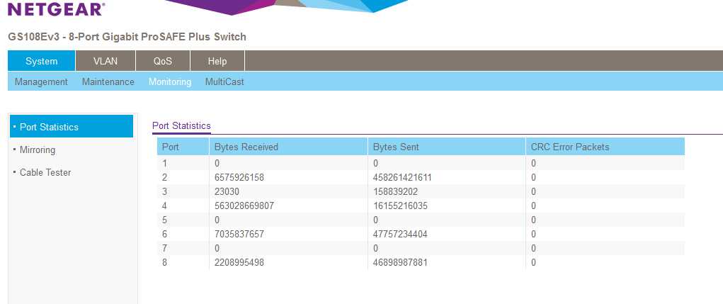

But as a budget switch with the ability to vlan then yeah its fine for that.  They mention "network monitoring" what they mean is you can look at the specifics of an interface for errors and amount of traffic.  But you can not monitor these ports via snmp, etc.
For example this is their monitoring page.. That is from my gs108e.
