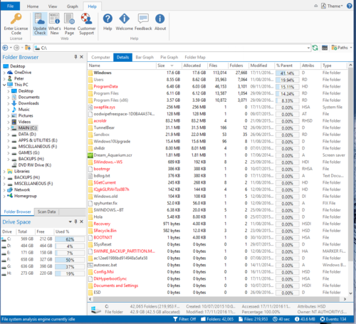

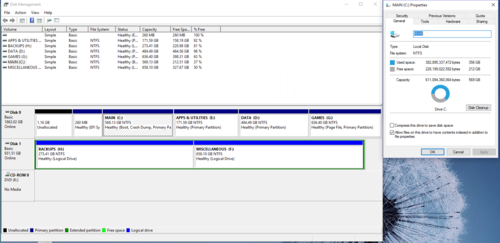

Thanks jjkusaf. The answer is 'Yes' I get the same total as shown in Properties of C drive. I have attached a couple of screen captures, one showing my drive configuration and one showing the Folders/Files on my C drive. From this you can see C drive is 569GB, of which 356 GB is reported used. Yet an analysis of C drive using my Folder Sizes program shows the total of all folders/files on C to be only 42.9 GB. In other words, there appears to be a massive 313 GB of 'stuff' unaccounted for! There must be something wrong somewhere...
If there's anything you or any of the other contributors who have kindly posted replies can suggest I'd be very grateful.

Why are folders RED?..  I would assume you do not have permissions to view these folders, which is why they show up as ZERO in size..
How do you have 5 primary partitions on a basic disk??
GPT allows up to 128 primary partitions. 4 was a limitation of MBR.
Yeah I know - but your disk shows its basic not gpt..
Oh my bad.. looks like basic can support gpt
https://msdn.microsoft.com/en-us/library/windows/desktop/aa363785(v=vs.85).aspx
Normally when using gpt you would see the disk as dynamic..  What tool is that your using?  Why does C list nt authority as owner??
Can you right click on C:\ properties and show the permissions tab.
Problem now solved.
Running my drive analysis program as Administrator (I wasn't doing that before) revealed a huge folder (315GB) entitled System Volume Information.
I then found that System Restore on my C drive was set to 100%! How that happened God only knows but I have now reduced it to a more sensible 15% and succeeded in clearing out many GBs of unnecessary restore info. I found how to do this clear out on another help forum: http://www.tomshardware.co.uk/answers/id-1813658/reduce-size-system-volume-information-folder.html  My C drive is now back to 'normal'. Thanks to all for helping solve this problem.
