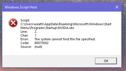

For the past week or so, my computer has been having a crashing problem in which i believe a hardware malfunction may be the issue. My top supporting factor is that for the past month or so, I've been getting this error every time i log into Windows.
But the thing is, when the system crashes, there's no green screen of death or anything. (I am running 17025 Windows 10 RS4.)

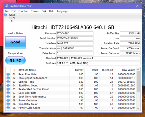

16 minutes ago, JoseyWales said:
Your hard drive is dying...
If it is (which is a possibility) I recommend using Crystal Disk Info to find out for sure.

that error is very suspect, any positive hits on "nvidia.vbs" flag up potential malware infection. The Nvidia driver does not use visual-basic script.
https://www.enigmasoftware.com/wormvbsjenxcusa/files/2/
Run a chkdsk on your system partition. I saw all my pcs crash after upgrading windows 10 to the latest version. Chkdsk fixed it.
Although Nvidia driver does look the most likely cause.
I have to agree with Mando here, your system is crashing on a VBS file not a SYS file and that's very suspicious.   A vbscript file is running in your startup folder.... hmmm. That just screams malware.   I just looked on one of my RS4 machines that has an NVidia GPU and there is no nvidia.vbs file to be found. I think you have something else going on there.
Gotcha! Thanks for the help, everyone. I haven't run confirmation benchmarks yet, but i will report back with results. I don't understand how an nvidia disguise trojan got into my system, but the bottom line is that it's gone, now. and i am no longer getting the startup message.
Also, I've run a CrystalDiskInfo scan, which detected no problems with the hard disk.

So far, me & 3-4 other people brought to your attention a VBS of nVidia in your startup.
I mentioned and joked "get rid of it - problem solved"  but others also mentioned it shouldnt be there.
You said you had no AV, but just MBAM - what did MBAM say ?
You need to have something else in addition to MBAM - MBAM's strength is removing the things that slip past your AV.
Did you just forget to run an AV ?  Are you in the habit of not using an AV ?  Were you relying on WIndows Defender ?
For AV, you can refer to neowin's list of AV software - I wont mention a recommendation because it will just derail the thread (because every person who isnt running what I recommend will chime in "Ive had [insert crap AV software] and I have no problems")
So, run MBAM again - does it pick up anything.  YOu mention the .vbs isnt there anymore, but then a little later - its back.  Did MBAM remove the .vbs ?
If you want help, you need to tell us what you did, and what the results were, of your actions.
Basically, we dont know 100% the .vbs is the culprit - its very suspicious, other claim they looked it up and its spyware - that might very well be the case.
