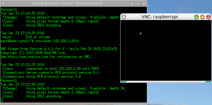

I'm at the point now where I am trying to get a vncviewer to log in and display X. I dealt with the free version not supporting encryption, and added settings on the Pi to not require encryption. But I get a small black window, instead of the fluxbox environment I see when I am locally on the Pi and startx.
Hardware wise, I know I need to get something to bring up the 3.3V serial levels to at least TTL levels, since we have been able to use USB serial adapters in Windows before, so the robots are able to communicate with devices that only send 5V.
If there are any thoughts on this, I'd appreciate the guidance, otherwise I will just recheck what I am doing to see if I overlooked something.  :)

As far as the progress on the Pi goes, I have problems getting VNC to work right.  Part of the problem is the default setting of the vncserver on the Pi is for Encryption=AlwaysOn, and the free version of vncviewer isn't capable of encryption, so I kept getting kicked out before I could even try logging in.  Googled and found that setting, and it now prompts for password, but when entered and connected, I get a small black rectangle, with the mouse cursor.

Solved the VNC issue.  The problem I encountered was due to the raspi-config utility sets up vncserver as a service, and I had the same problems when running it as a user and trying to connect to the display :1 it created.
The solution was to disable that service, and I ran the command
sudo systemctl enable vncserver-x11-serviced
which set up the vncserver-x11 service daemon to start on init.
