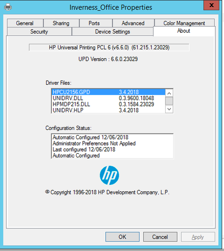

Storm Posted June 12, 2018 Share Posted June 12, 2018 Im having an issue following HP's Drvier preconfiguration guide Im using the latest version of the universal print driver and thus have a file called hpcpu215.cfm saved in the %systemroot%\system32\spool\drivers \x64\3\ path Install the driver Select one of my printers and choose the new driver Settings work as expected, this is the tab shown under the printer: I then use this Powershell script to change the driver on all of my other printers $driver = "HP Universal Printing PCL 6 (v6.6.0)" $printers = gwmi win32_printer foreach($printer in ($printers|Where{$_.DriverName -like 'HP Universal Printing PCL 6 (v6.2.1)'})){ $name = $printer.name & rundll32 printui.dll PrintUIEntry /Xs /n $name DriverName $driver } Which changes the drivers as expected; However, when i then go into the settings of that printer; the driver is no longer using my preconfigurations. Been tearing my hair out on this, if anyone has any ideas that would be amazing. Link to comment Share on other sites More sharing options...

kej.android Posted July 9, 2018 Share Posted July 9, 2018 Hi Storm, Just in case you're still watching this thread, I just wanted to confirm that this is happening here too. It looks to be a bug specifically in the v6.6.0 drivers. I've thrown my bag-of-tricks at it a number of times but the they keep sliding off. The only thing to suggest here is stepping back to the v6.5.0 drivers and then asking HP to look at it. I will as soon as I have time! The best I've got so far is that there's a caching mechanism being used nowadays and it looks a bit logistically tied up for the latest drivers. I haven't yet managed to find time to try all the angles and identify the breaking point but my gut feeling is that HP have dropped the ball on cross-testing the caching of settings properly for all deployment methods. right now, the .CFM drop method has interesting programmatic issues that people like yourself and I only notice from our front-line usage. FWIW - From what I've seen so far for the newer drivers; 1) During the driver staging, the .CFM file gets copied to a .CFG file with a name related to the driver's name. The name is different for generic vs specific versions and also for the flavour of driver (PS vs PCL) so you get things like "hpcpuXYZ.cfg", "hpcpuXYZ_PS.cfg", "hpcpuXYZ_P6.cfg" appearing in the driver directory . 2) When the queue "instance" is created from the pre-staged driver, a copy of that generated .CFG is added to "%ProgramData%\Hewlett-Packard\HP Print Settings" with an abstract name such as "HP<6-digits-in-lowercase-alphanumerics>.cfg" that links back to the print queue itself via a registry entry. I've monitored those two stages separately with ProcMon and the pre-staging seems to open all the right files and should work. Watching the first instance of a print queue being created vs the second is interesting though from a coder's point of view. When the first instance of the queue is created, you can see the abstract files being created in %PROGRAMDATA% twice which suggests to my programmer head that the there's two code paths running in turn. The first code path fires to properly read the config files and set up the registry keys to initialise a working queue and leaves you with a working setup. The second code path (most probably what fires up secondarily and then also for every instance from then on) probably fires correctly but doesn't appear to actually do anything useful. (It seems to write the registry entries correctly but just lacks the code to prod the queue to reload the settings and leaves the queue working with whatever it had in memory at the time) My gut-feeling is that HP have just whoopsied the code a bit... trying to explain it without hours of detailed work might take a while though... My best advice is to step away from the v6.6.0 drivers if you can avoid them for the moment and just use the v6.5.0 until the dust settles. Regards, Keith Link to comment Share on other sites More sharing options...
