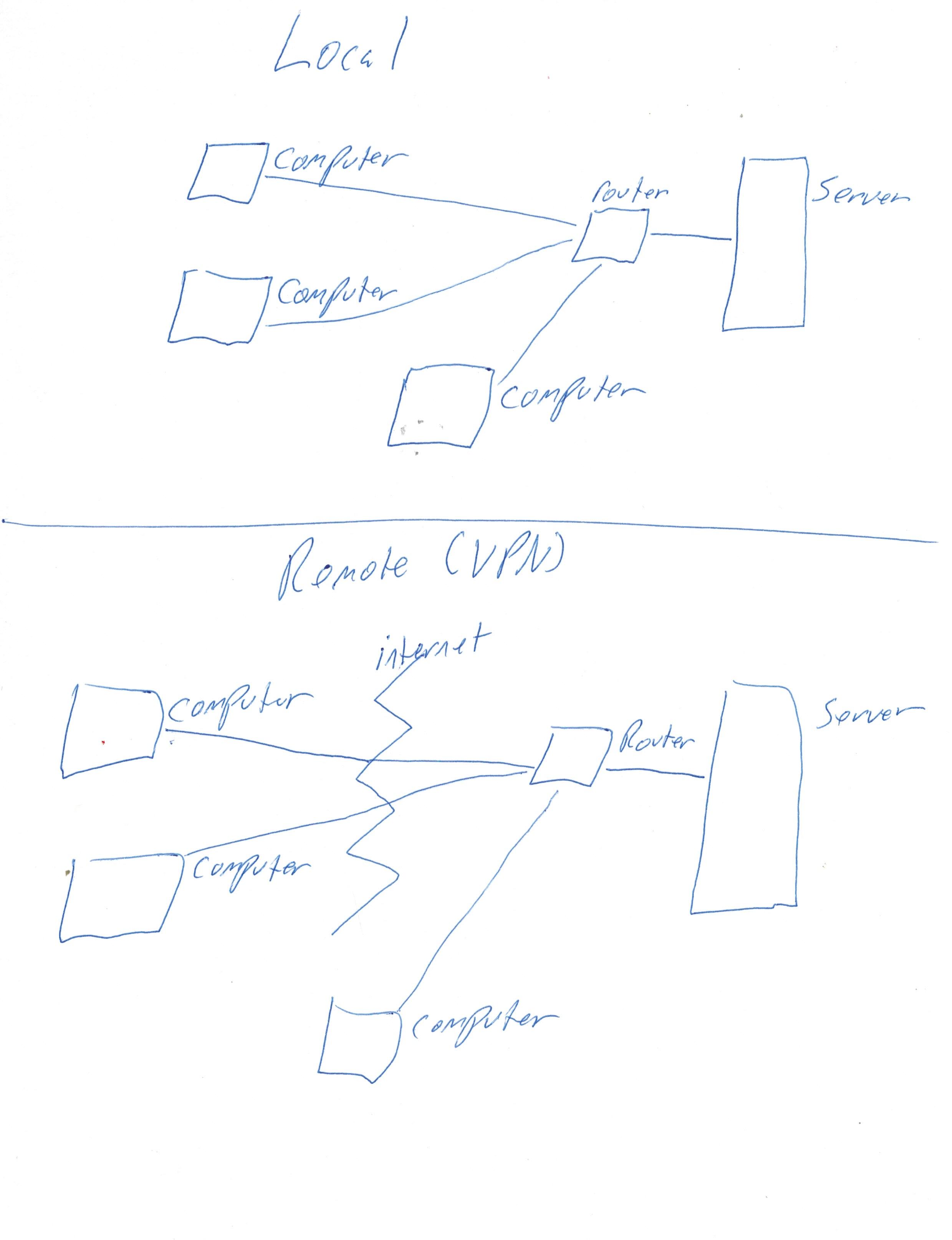

You have a VPN router, and your trying to run VPN on your server?  Drawing would go a long way here!!!

So again going to ask for a DRAWING!!

I've attached a drawing of the network.  It's really not a complex setup at all.
There aren't multiple routers.  These computers remoting in are not on different networks.  The VPN Router is a Vigor product from Draytek and shows these remote computers as being connected (these computers recognize that they are connected as well).  However they do not have access to resources on the server.
The server is hard wired to the router.
All computers are wireless (when local) and connected through the internet (when remote).
I hope this helps my explanation make sense.
Connected to what?  The tunnel network?  What IP does the client get.. The vigor support multiple types of vpn - which one are you using?
https://www.draytek.com/en/faq/faq-vpn/vpn.host-to-lan/windows-10-built-in-vpn-to-vigor-router/
These instructions are HORRIFIC!!! They have you enable PPTP.. JFC!!  That has not been secure for YEARS and YEARS... Please tell me you do not have that enabled..
See the tunnel network 192.168.46.. What does your client get for its IP when it connects.. simple ipconfig /all will show this.. Unless you are doing a bridged, layer 2 network where the client gets the same IP network as the server is on - your not going to be able "browse" for anything.. And again if your IP is different than your servers - its firewall is not going to allow you to talk to it.  So either you have to set that int he server, or you would have to be doing a bridged L2 connection or you would have to source nat the connection.
