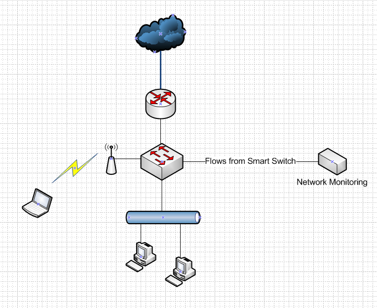

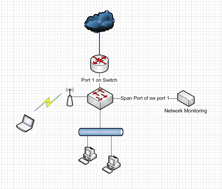

So one method, you span the port between your switch and router
This would allow you to report on all traffic to and from the internet
Depending on the feature set of your switch - could could send the flows of traffic from all on the switch so you could report on internet and traffic between any device on the switch
There are different protocols to accomplish this depending on the feature set of your specific switch.. SNMP sure could be used to just view the ports stats on traffic, or something like sFlow.

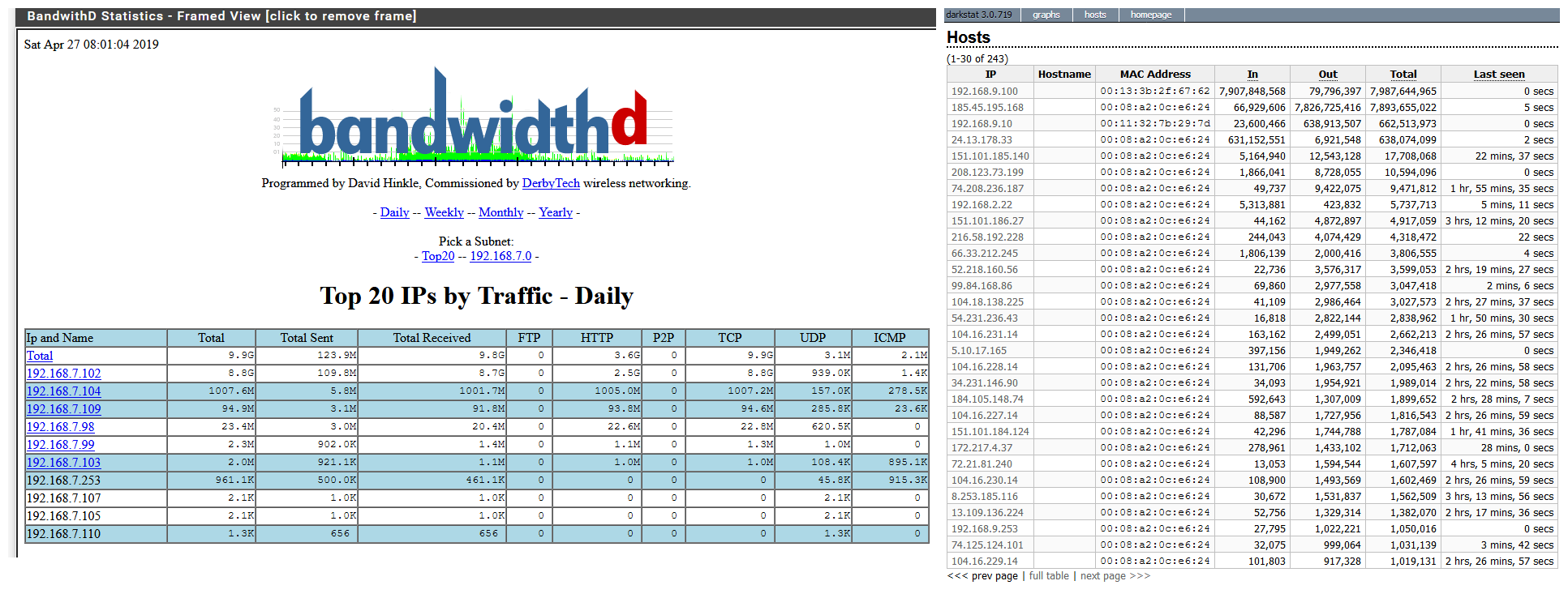

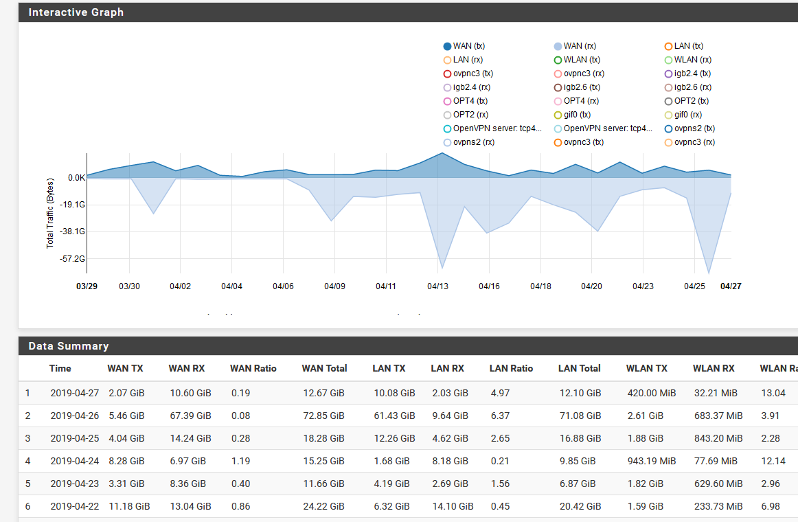

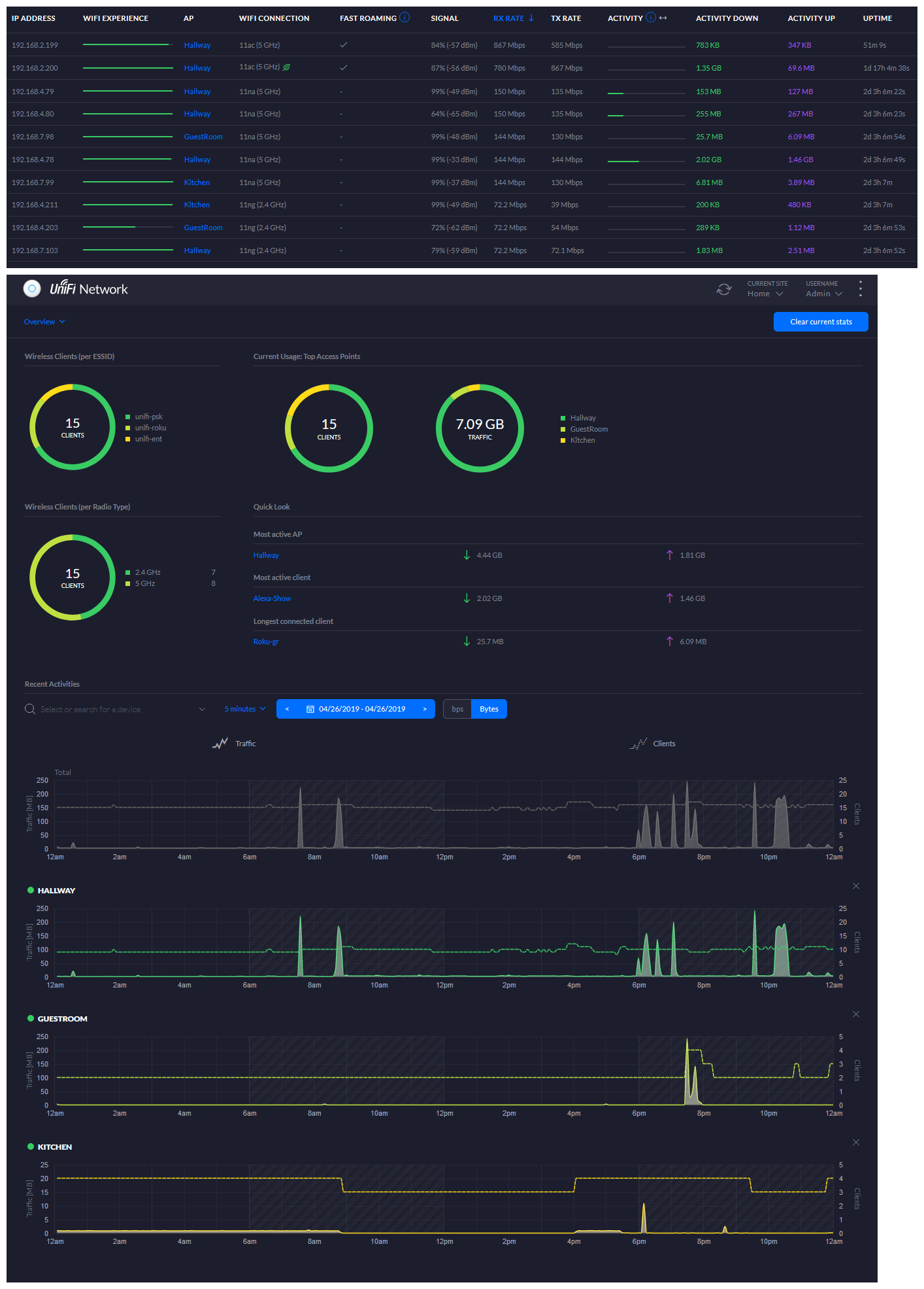

There are LOADS of different tools you could use - here couple of examples running on my network for different reasons and functions.

If your to the point where your wanting such monitoring, its prob going to mean you upgrade your hardware that is more feature rich.  A smart switch that has the ability to at min span ports - so you can tap off traffic and send it to something like even a pi that could run software to report on traffic details.. And an AP or APs that allow for such monitoring.. Or atleast the ability to grab info from them via something as basic as snmp... Even the dumbest of dumb wifi router that you could just use as AP connected to switch with some feature would allow you to monitor atleast "total" wifi traffic flowing through the switch port the ap is connected to.
