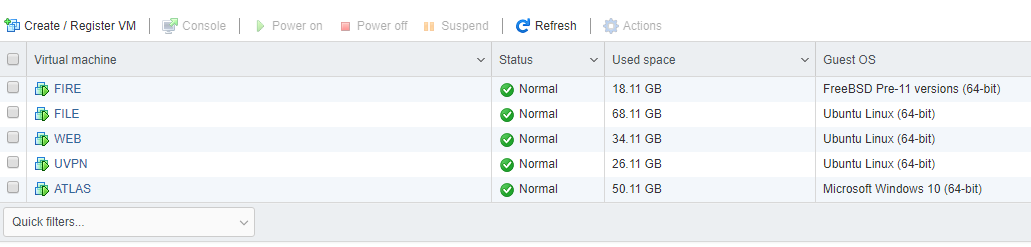

I'm in the process of moving toward containers on my setup, however as it stands:
Home Server Setup: Firewall/pfSense VM, File Server, Web Server, VPN/Project Server, Windows 10 VM. My 6 core i5-8400 barely breaks a sweat, and I'm never wondering why, or regretting only getting an i5 six core proc.
Before last year I was running everything below on an intel i5 nuc (skylake). Only reason I upgraded was because I wanted quad nics, which resulted in a new build.
I need to bump up my RAM though to 32GB. Limiting some projects.
