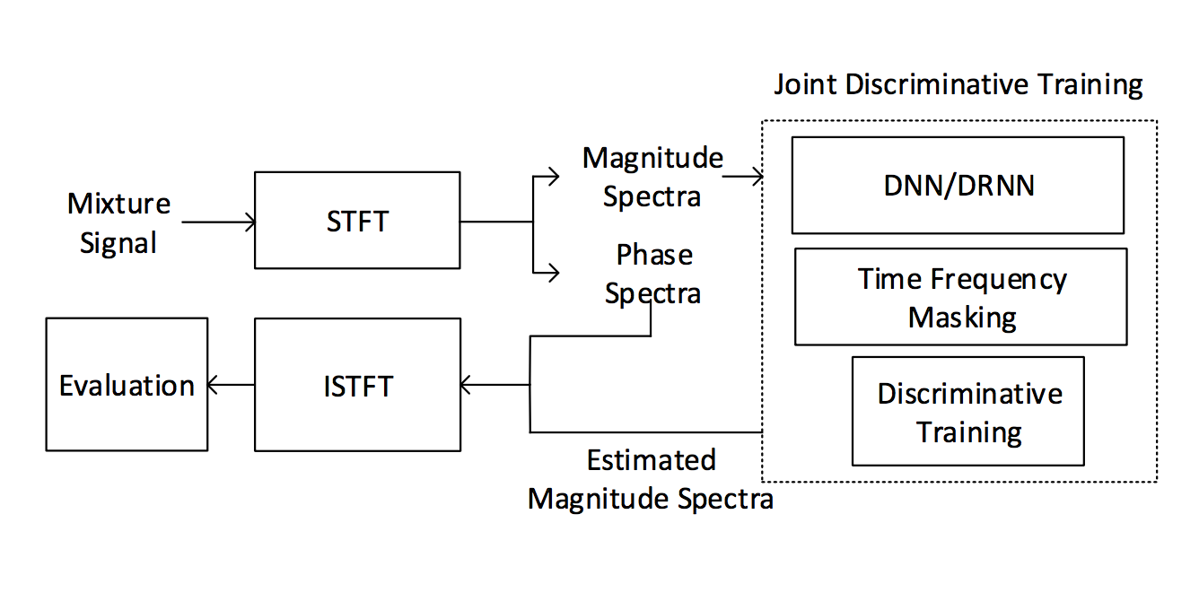

Maybe it is useful to get up to speed with how audio processing can be done outside the limitations of twiddling knobs. Here is a survey of some of the ways AI is applied to audio processing:
https://github.com/ybayle/awesome-deep-learning-music
And here is an example of separating out the vocals in music which I'm guessing is harder than clapping:
https://github.com/andabi/music-source-separation
A demo of an earlier version of that algorithm:
