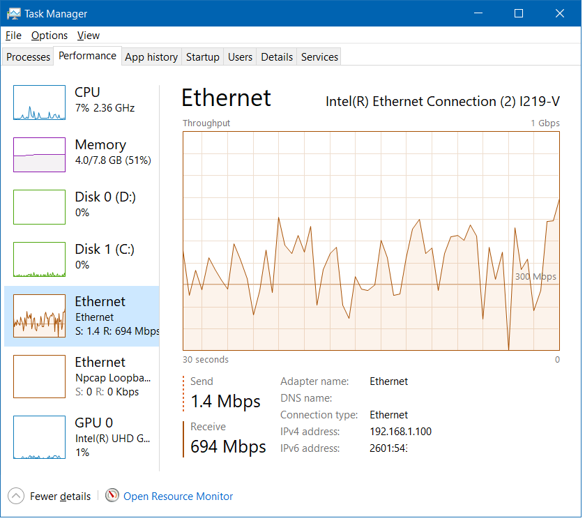

I have a US-24-240W POE switch which powers a bunch of PoE devices I have. I have noticed some odd things lately with it like RDP lag and blocking (like you get MPEG like artifacts when using RDP to another client on the same switch, almost like it went to a very low bitrate mode). I also noticed recently my 1Gbps internet connection runs around 250 to 450 Mbps randomly up and down (if you do a long running multi site speed test you can watch the NIC status on the client system do a saw tooth like pattern but not that consistent)

Plugged the router into the US-24-240W switch, and the desktop into that and boom all over the place again...

but anyways attached is what I am seeing in windows when I copy a file between two systems on the same switch.... you'd think it would be more flat no, its from 200Mbit to 700Mbit constant... put on another switch it stays constant at almost gigabit and flat line basically

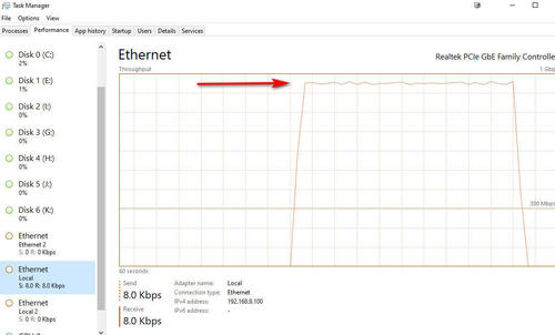

Yeah that is horrible..   I don't have any of their switches to test with..  But file copy has a but more involved then just moving packets... you should do a iperf test..

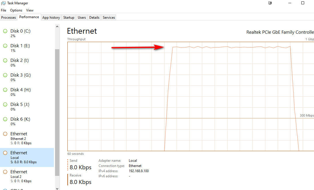

And here is other direction - this is what you should see normally on a gig connection doing testing.
Have you tried changing the cables?  Rebooting the switch?  You will have to look into why the index is bad - are you seeing a lot retrans or errors on the interface on the switch

yes, changed all the cables, did a factory reset on the switch.. same thing... odd thing is iperf I get a flat line at 934Mbps both ways.. but if I use a HTTP bandwidth test hosted locally its all over the place again when its on port 80... change it to port 1000 and flat... change it to 3389 and all over again...
