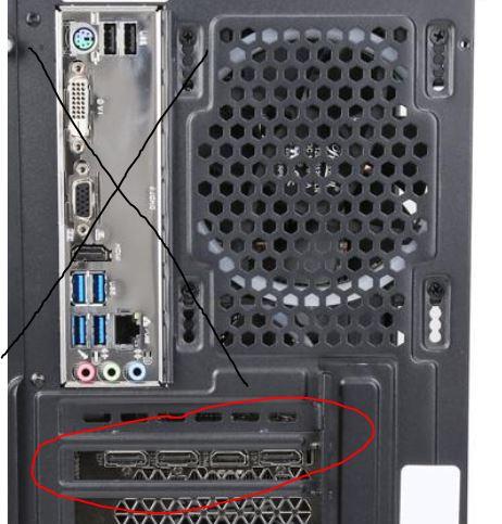

Yea, make sure you are plugged into the GPU.  It seems this PC has the Ryzen 2600 so the video outputs on the motherboard will not work (the Ryzen 2600 does not have an integrated GPU).
https://www.newegg.com/abs-computer-technologies-mage-e-ala107/p/N82E16883102697
See below image for clarity.
Expand
I know this first hand. ;) (see my sig)

Some, yes, but he doesn't have an APU, so onboard has no connection with the CPU.
