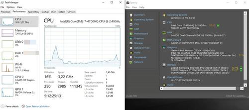

I was wondering... what can be causes for a (very) high CPU-temp in idle mode?
Speccy reports on most occasions 80-85+ Celsius temps (sometimes even 94/95 degrees). And the fans are making quite some noise.

well your machine isnt idle for a start it still has usage, and i would use something that can show you what each of the core temp is, because that just shows 70C....well what about the other 3 cores?
Is there an app/program for I can use?
