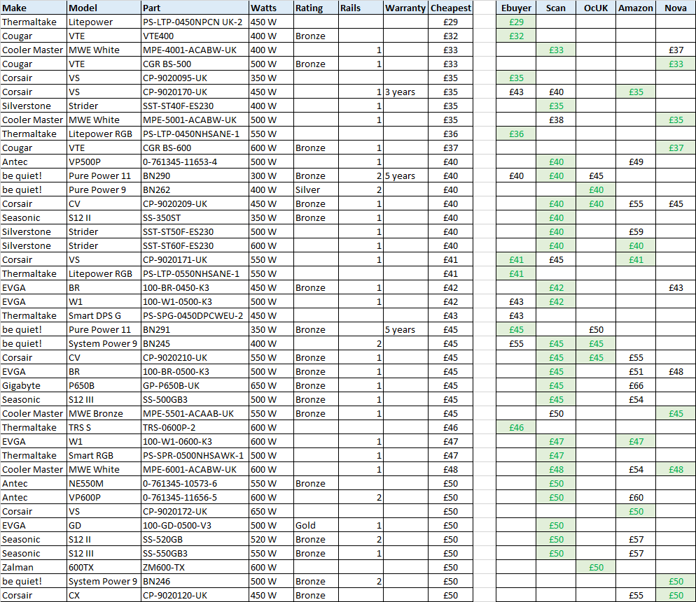

Here's my initial research:
I'll bulk it out over the next day or two.
1 hour ago, Elliot B. said:
These guys say a regular PSU should work fine in the T1600.
I don't want to spend a lot on the system as it's only a basic Plex server (hardly even transcodes). No more than £50.
If you want to stick to well-known brands is up to you. I have a corsair, not sure if it's the £35 cp-9020095-uk one on your list but it's similar styled and can recommend that. It has white 80+ certification so it's roughly 80% efficient compared to the 65% one you have now. It has 4 SATA power plugs and 1 floppy, so you will need a floppy power cable to molex, should be pretty easy and cheap to find.

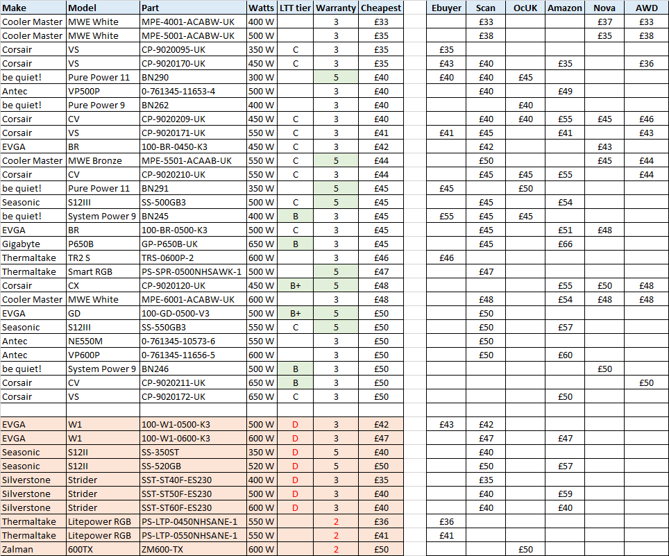

Updated table:

Probably just the cheapest Corsair (the 450w on Amazon for weird-symbol 35)
Though I still think you'd do fine with what you have....especially if you're not wanting to spend a lot of money.  The add on card isn't really using that much more power ... probably just drawing 10w off the motherboard (if at all) and using the molex to sip another few watts off of (or being powered solely from the molex).  USB 3.0 2.5 HDD drives use what... 2.5-5watts or somewhere around there.
Anyway...I doubt that card ... fully maxed out with 4 2.5 HDDs ... would use more than 15 watts (I couldn't find technical specifications on this card to confirm).
Granted ... with the age of the system ... it probably wouldn't hurt anyway to get a new PSU if you can budget for it.  Just my opinion.  🙂
