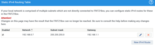

I'm a not really experienced in network configs, I mean now the numbers of SUBNET MASK, etc.
My setup currently is:
Router: 192.168.1.1
Devices: 192.168.1.10+
I've got a NAS from a friend, which is configured for 192.168.0.1 as gateway and has an IP also something like 192.168.0.X. I don't know the exact IP of the device but in general, what do I need to do to connect the 192.168.0.X to my 192.168.1.X setup?
I believe I need to setup a IPv4 routing on my router?
What do i need to enter as value to connect the 2 subnets?
