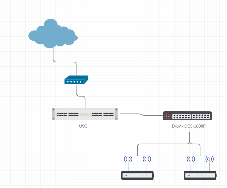

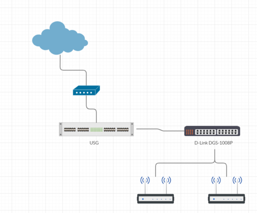

To be honest 3 vs 1 on dtim would prob make that worse..  How exactly are you setup?  What is the layout of your network.. You said usg and some AP - but are the ap wired, or using wireless uplink to each other?  Never ran dhcp on the usg myself - running it at my sons place, but its only been a week or so - and to be honest just the little bit been over there setting stuff up, have seen some dhcp issues.. shrugged it off - because it worked after a bit, etc.
I have my cable modem attached to my USG  which is connected to a switch and the two APs are hardwired to this. Like below
