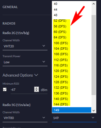

And what channel are you running on.. When you set that up and trying to use 80 VHT that determines which other channels are to be used, client might not like that, or there might be interference on the other channels of the VHT.
"Wireless Channel is Auto"  really wouldn't be a good idea if trying to use specific settings for the VHT channels to use..   I would suggest you set your specific channels..
On 5 ghz there are really only 2 channels that can be used for 80 VHT.. 36 and 149 if not using the DFS ranges.  Those would be the lower channels and then the upper channels would be used for the VHT..

I set it to 149 to see what happens. Can experiment with this. I live in a small apartment and interference could easily be the answer. Strange that only one device is impacted... maybe all the others are using a channel that's not being interfered with? is that how it works when it's set to auto?

14 hours ago, capr said:
so if interference is the issue, there has to be a channel that doesn't have interference which i was using before.
Possible... And its also possible someone moved in or changed there setup and now there is interface on all the channels.
You really should fire up something like
https://www.acrylicwifi.com/en/wlan-wifi-wireless-network-software-tools/wlan-scanner-acrylic-wifi-free/
To see what is out there - how strong the signals are, and what channels they are on.
The other option if all the known channels are being stepped on, is having a router (and the client) that support the DFS channels.. Pretty much nobody uses these - since most soho routers do not support them, and clients like tvs, iot, etc. most likely don't support them either..  (52-144)
Its always a good idea to do a survey of your area to see what is the best channel(s) for you to use.. You want to use the channel that has the least amount of signal from others in your area..
