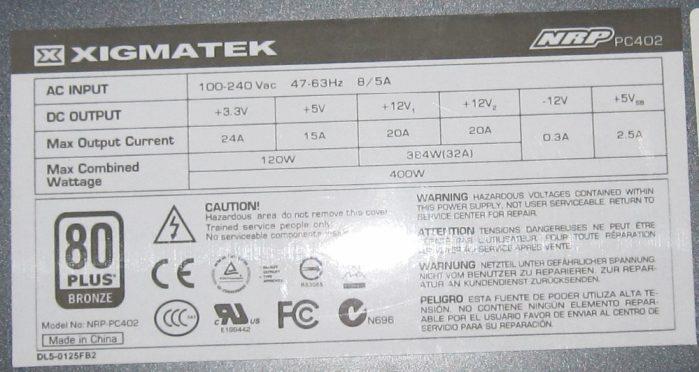

If it follows the standard color scheme ... the yellow will be +12v.  If you have two rails the 2nd rail probably will be a yellow wire with a blue stripe.  Blacks are ground.
Check the label on the power supply ... what does it say with regards ..
This old PSU of mine has two +12v rails @ 20A (though I suspect it really is just one rail from one supply circuit since I get resistance between the yellow and yellow/blue)...meaning I could safely bridge the "two" rails if needed.  But I digress.  Don't do that.  🙂
Biggest question ... what is "something else" that you're thinking of powering? 🤨  If "something else" doesn't exceed the output delivery of the rail (including any other devices/hardware using that rail) you should be fine.

Yea, all the yellows are carrying your 12V. I don't really see a problem with what you're trying to do at long as you're not exceeding the Amps.  I think (and could be wrong) the wires coming out of the PSU are 20 gauge...which is ~10A rated (not factoring length of wire...the Amp rating will drop as wire gets longer).  No idea what a "model railway" would require.
tl;dr yea, they are carrying 12V but don't exceed overall amps of PSU or the individual wires.
