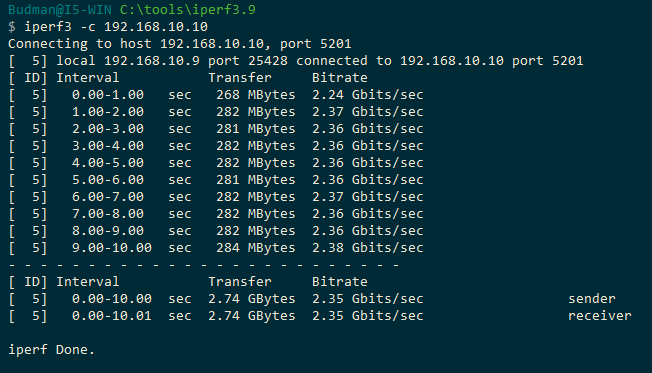

Here is a test I did for another thread elsewhere trying to explain what happens when you start moving traffic.  So running ping to my nas, which is local - normally see about 0.5ms response time... But start moving even some traffic, this was moving 200mbps on my gig connection and you will see that time go up, even locally.. With only switch between you.  Now start thinking about how many hops your doing with routing and lower end speeds not full gig.. As you move up your network to your isp to the internet.
While ping time going up is a indication that your line has traffic on it - doesn't always 1:1 relate to response time in a game..   I wouldn't be all that concerned with an increase in ping times as you play a game or stream a movie, download a file, etc. because its going to be a given that yes as you fill up a pipe  the time for any specific packet to move through the network is going to take a bit longer.  Since now you have a lot of cars waiting in line to get on the highway, vs the onramp being empty.

Depends on what your doing.. I can tell you for sure.. Wireless even AX can not do this.
When you moving large files back and forth from your PC and your nas... There is a big different between 113MBps (gig) and like 270+ish MBps..
Do that with your wireless ;)  While sure you can see gig speeds with AX..  Still doesn't compare to a wire.. Never will.. Wireless is fine for mobile devices.. But when I want to move data, wire is going to win ever single time..
I don't use a normal NAS, so indeed.  You were talking about gaming though, not heavy file transfers.
AX runs on 5ghz ;)  So if user can't use 5ghz, and has no devices for 5ghz even?  He wants to turn it off - don't see how AX would help him..
You don't need AX for gaming either ;)  2.4ghz is fine for gaming from a bandwidth perspective.. But wireless be it G,N,AC,AX is not going to be as robust from a connection standpoint as a wire either.. While you mesh system will provide better wifi and can provide for a more stable connection sure..  In a small apartment, mess is prob not going to help all that much - because its not area he needs to cover but interference from all the wifi in the area.  5ghz should and would be better because you can use channels that are not normally used, and have less range, even in an apartment setup..
Wire there is no interference.. And you don't have to worry about signal strength, and you don't have to worry about shared bandwidth.. etc. from a gaming perspective - wire wins hands down as well.
