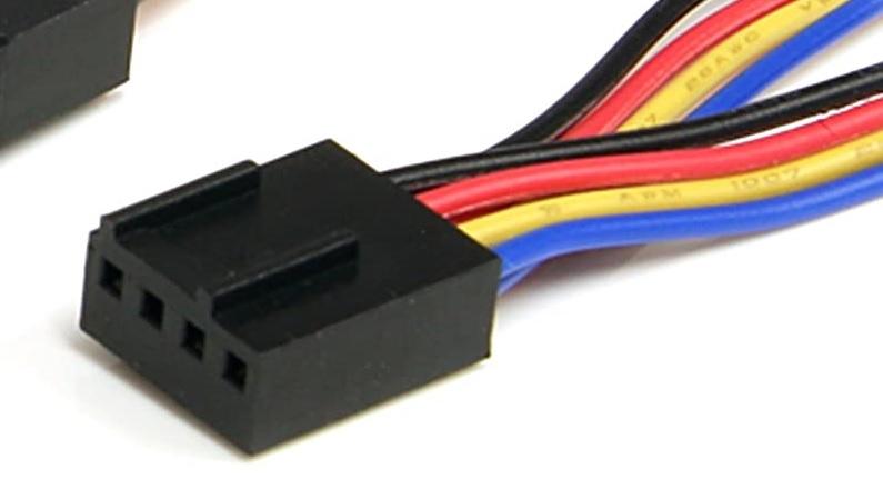

4 pins means, Fan speed can be controlled by software, 3 Pins does not have that option,
usually there is a boundary separator on the connector for 3 pins so you can easily fit 4 Pins connector on 3 Pin junction and vice versa.
like in this picture, so you can easily left the 1 pin.

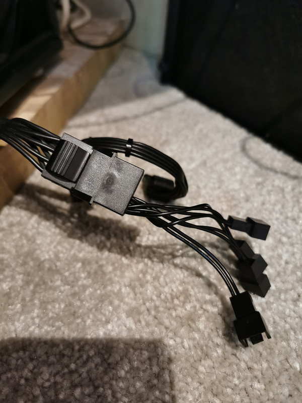

Managed to find my photo:
Think I'll have to butcher two of the connectors to make it fit but you can see here there's just the two cables to each one anyway.
Although from another hobby, seems easier to cut the plug off and solder the wires to a new male pin to put into the female fan plug.

That does not look like Fan's connectors, what kind of Fan is that? is it casing fan?
yea, it should work.  Just match your Ground / 12V/5V ... you'll just have to cut the lip (furthest away from the wires) to make room.  Seems kinda janky ... but whatever.  :)
That's an adaptor that is fitted to a modex connector from the power supply.
The little connectors are 3 pins (although actually just 2), which were connected to two case fans.
Motherboard has one connector for a 4 pin fan but I have three fans to fit so need to change some of the little connectors (in the photo) or buy another one that is already fitted (but post around here can be a little off... covid and all that).
This is where my knowledge breaks down... I have a multimeter but don't really know how to use it to find the right connectors.
I guess I touch the red lead to one of the pins from the molex, and see if it jumps to 12v? And the black lead needs to go to the other pin on the molex?
Just to bring this to a conclusion, it was easier than I thought.
Snipped off one side of the connector (on the molex adaptor) and slid my fan connector on.  Works fine.
Whether it was worth the effort, I'm not sure 🙃
