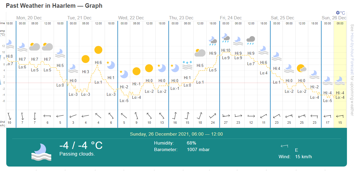

When I keep my airco's heat pump on 19C (66F) 24/7 I am using around 9.5kWh a day. (in mild weather)
When I schedule it to heat 20C between 7:30am - 9am and then 19C between 9am and midnight, then 14C between midnight and 7:30am I am using around 6.5kWh
This week though it has been below freezing at night and during the day, so my usage has gone up quite a bit. On the same schedule last week I used 34.6 kWh and this week it has been 64 kWh (so far).
Wednesday was my highest use at 16 kWh, but as you can see it stayed below freezing all day. But Monday and Friday on the same exact schedule only used 6.1 kWh.
It matters when I am not heating at 20C between midnight and 7:30am and saves me around 3 kWh day (in mild weather, such as Monday or Friday in above graph).
My house is 110 years old around about, and could do with an investment in isolation (all rear double glazed windows, facing South have a leakage).

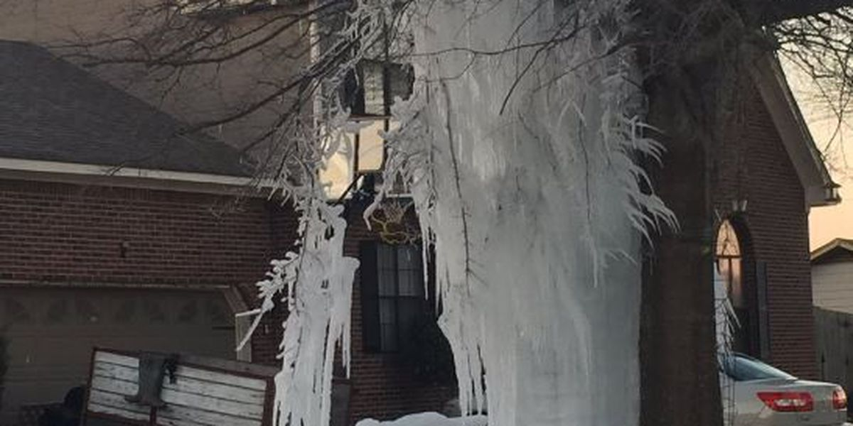

On 26/12/2021 at 14:03, Steven P. said:
Nest suggests keeping the gas central heating temp set to no lower than 14C to prevent frozen pipes.
Reminds me of this:
https://www.neowin.net/forum/topic/1414069-house-heating/#findComment-598699938
This is why I put the electric heating on! Though, I was not aware 14c was the temperature where things start going bad lol I'm just too cold xD.
