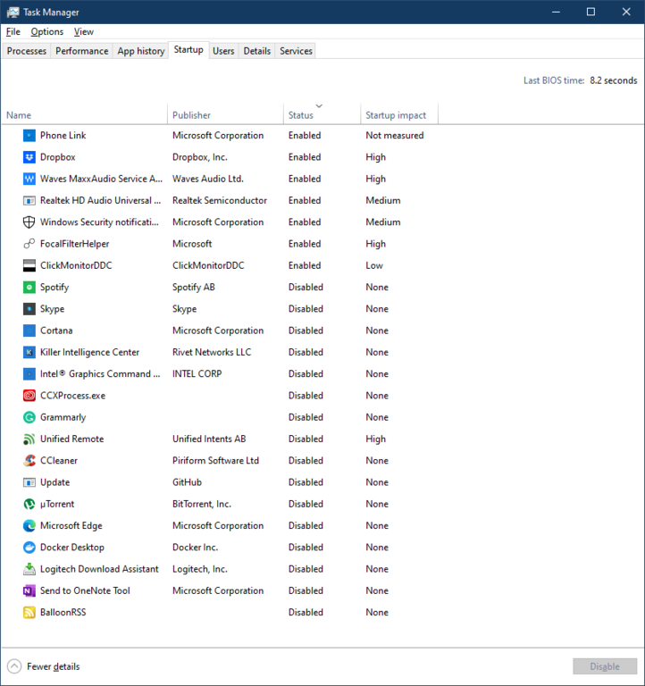

Jose_49 Posted October 21, 2022 Share Posted October 21, 2022 Sup everyone! I have a laptop Dell XPS 7590 - 32GB DDR4, Intel NVMe 512GB (SSDPEMKF512G8 NV), Intel Core i7 9750H. After a while, my PC begins to present serious slowdowns that shouldn't happen based on the daily programs that I use. The PC locks down (mouse becomes unresponsive, and can't type) : - From time to time, while browsing the web, writing some code, or working with a simple Excel file (No complex formulas, 3 - 4 sheets) - Every time there's a new hour (Say, from 8:59 AM it became 9:00 AM) Here's what I've tried: - Check in both both Process Monitor and Task Manager for CPU, GPU, and SSD usage. None of them show a spike. In fact, they remain below the 9%. - Ran sfc /scannow (No integrity violations found) - Ran CHKDSK (no issues found) - Ran CCleaner. - DIsabled most startups program - Ran MalwareBytes (Did find a couple of trojans a while back, and a crypto miner, but haven't fought back). - I've ran all Windows Update and checked with Dell to keep my drivers up to date. Here's what I noticed: - If I format my PC, the computer is blazing fast again. - I believe there's a program that is locking up my PC but I don't know which or how it is doing it. Programs that I frequently use: - VS Code (Programming) - Excel - Outlook - Spotify - Postman - Groove Music - Foxit Reader - One Note - Firefox - Edge - Vivaldi - Docker with ~2 containers running - ClickMonitor DDC - Grammarly (These can be the culprit sometimes, but I only enable it from time to time) - Power Toys - Dropbox - Slack Programs that I use from time to time. - Premiere - OBS Other notes: - The PC is 2 years and 10 months old. - I repasted it around 2 years and 5 months and applied some thermal pads to it (When I used to game more frequent). - I haven't repasted in all this time. - It hasn't been cleaned in a while.... Probably should check out its dust levels... Do you people have any ideas? Link to comment https://www.neowin.net/forum/topic/1422602-ffs-how-can-i-fix-my-slow-pc/ Share on other sites More sharing options...

+Warwagon MVC Posted October 21, 2022 MVC Share Posted October 21, 2022 What I would like to know, is what the heck is using 23GB of ram. Go to details in the task manager and arrange by ram usage. My guess is time goes on maybe you are getting up to 90% ram usage which would definitely slow a computer down. I just saw you have docker and 2 containers. That's probably it but may want to check anyway. Do you ever get to 90% ram usage? Link to comment https://www.neowin.net/forum/topic/1422602-ffs-how-can-i-fix-my-slow-pc/#findComment-598770794 Share on other sites More sharing options...
+mram Subscriber² Posted October 21, 2022 Subscriber² Share Posted October 21, 2022 Seconded on the Docker containers. What exactly is being run there? None of your other running software should be an issue. Turn off your docker containers and/or disable them and see if the issue improves. Link to comment https://www.neowin.net/forum/topic/1422602-ffs-how-can-i-fix-my-slow-pc/#findComment-598770797 Share on other sites More sharing options...

Jose_49 Posted October 21, 2022 Author Share Posted October 21, 2022 (edited) On 21/10/2022 at 20:55, Warwagon said: What I would like to know, is what the heck is using 23GB of ram. Go to details in the task manager and arrange by ram usage. My guess is time goes on maybe you are getting up to 90% ram usage which would definitely slow a computer down. I just saw you have docker and 2 containers. That's probably it but may want to check anyway. Do you ever get to 90% ram usage? Thanks for the feedback! Nah, the Docker containers are pretty inoffensive: Postgres and PG Admin. I think the high RAM usage was because of Windows holding some old programs into memory. I hadn't restarted the PC in several days (note that the problem has been present after several restarts). After rebooting I got back to 15.2 GB (Around 49%). Link to comment https://www.neowin.net/forum/topic/1422602-ffs-how-can-i-fix-my-slow-pc/#findComment-598770829 Share on other sites More sharing options...
