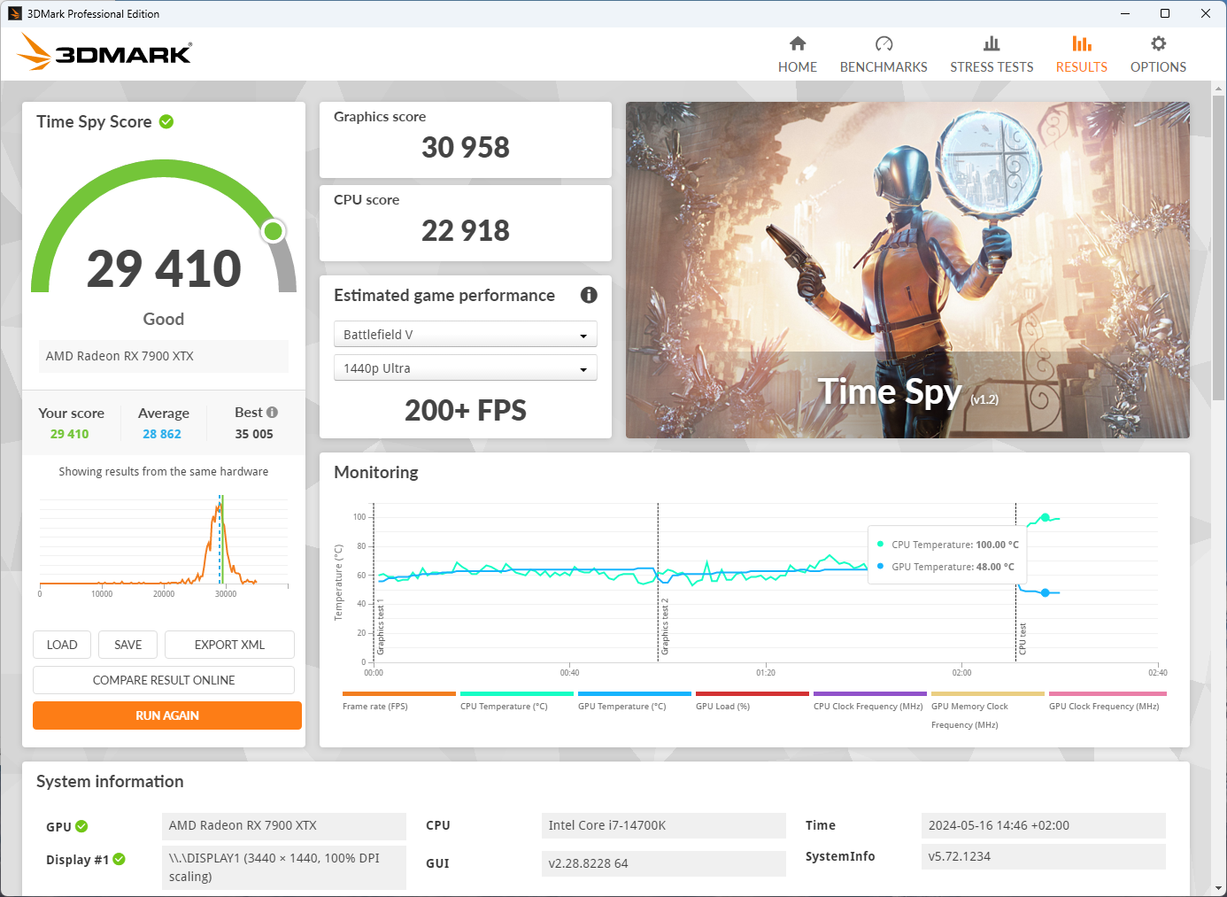

I don't want to hijack the thread, but you could also consider building an NR200P Max with an AMD CPU (super efficient)  https://www.amazon.com/Cooler-Master-Mini-ITX-Triple-Slot-Tempered/dp/B09CF4YGJ8 you'd still come out at around $1,000 if you don't go crazy on the dGPU.
From personal experience.. do not pair the NR200P Max with an i7-14700K unless you are cool with screwing around in the BIOS to lower power and tweak it so it stops throttling. You'd be better off going AMD 7xxx series.
I ran this (and other benchmarks) today, look at the CPU temp.. I am running these with the default BIOS settings on ASRock Z790 PG-ITX/TB4, I only switched to the XMP profile (7600 MT/s CAS 36 memory).
I have the default NR200P Cooler Master water cooling (top of PC) and extra bottom intake fans (2x 120mm slim Noctua) which helped a bit.
But that is also a route you can go if you don't want a huge tower. A 4060 Ti/4070 Super or 7800 XT would fair better than the 7900 XTX that I built into mine, which killed air flow.
