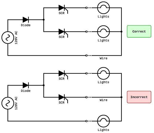

Hi all. I've had this line of chinese new year lanterns (basically christmas lights) for a long time, but then wires have completely deteriorated. They came from a Chinese store back in 2006, real nice set, but they're unusable now :( Thought I'd go and cut up some modern christmas lights and rebuild the set by hand. I went and tested them, but 1 side keeps blowing out. I'm certain that I'm not terminating the middle wire correctly. I know nothing about schematics or symbols, so I just drew a crude diagram. Two of the lines have 9 lights each, then there's the middle wire and I'm not sure how to terminate these lines. Might anyone know?
So far, I tried connecting all 3 together at the end, which leads to one side blowing out.  In the drawing, the right line blows out, left side does light up, but none of the bulbs are affected by the blow out of the right line.
There's also the possibility I connected the wrong wires to the controller in the wrong order. I'm almost certain the middle was the line with no lights, could be wrong.. Suggestions?

That post is indeed very similar to yours. Since yours uses incandescent bulbs, it won't need the inline resistors. And there are some minor differences around the control chip. But other than that, it's essentially the same thing.
Your idea of tying all 3 wires together at the far end is correct. The third wire is just for current to return from the far end. Assuming all the connections are soldered tightly and the bulbs are good, the problem must lie on the controller board.
I would suspect one of the 2 SCRs (black components with 3 leads) next to the outputs. Either that or the controller chip, but there's nothing you can do about that.

Well it turns out the board is shot. I might have.. killed it. Apparently the wire without lights (going to the mains) is supposed to be on the far left with the capacitor, not the middle. The other two lines have the 3 prong components (pcr406's), those lines were meant for the lights. Not sure how I missed that. After rearranging them in the right order, nothing turns on anymore. I did manage to locate some of these lights on a Philippines online market called carrousel. I'll see if I can order one of those and this time put the wires in the right spots. Sorry to trouble you :(
Well I hope you get something that you are happy with.
You are correct that the return wire should go straight to the plug, while the ones with bulbs should be connected to the SCRs. Having them in the wrong order would cause the current out of one SCR to flow through one string of bulbs, while the current from the other SCR would flow through both strings in series. This would cause bulbs to be on/off/dim at unexpected times, but it shouldn't cause any damage. So that is strange.
