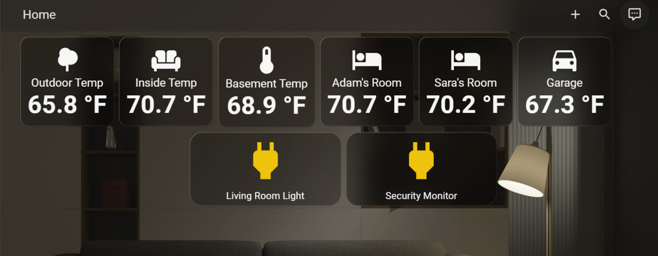

So I added home assistant support to my caller ID companion app. Then I added the sensor data for the outdoor, indoor and basement (yes I have 3 receivers)
It also maps the temps.
487016594_10162364918202768_7239740697803573222_n.jpg.6b76dc21c734c10169ce02f0bbc9ce56.jpg
Here is my call ID companion app with the home assistant support and the temps
487213614_10162364918577768_5921138521097995021_n.thumb.jpg.42e743f733fa244b30e95e608e2384d6.jpg
In the morning in real time you can watch the temp go up 45.6, 45.7, 45.8

So I had 3 extra AcuRite wireless Thermometers laying around since I replaced the other 3 to also monitor humidity + temp
So I also put 1 in the garage and the other 2 in bedrooms.
I think think this is cool, watching the temp fluctuate in real time.
