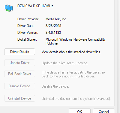

Getting the drivers from MSI isn't the latest. You need to download them directly from Mediatek. They'll have the latest.
Well i can't find any to Download directly from Mediatek, believe me i looked around lol.       So was getting them from MSI motherboard support site or Windows Updates since got machine in July 2024
Did search by Model of the Wireless & Bluetooth chip on Motherboard,  did find Mediatek drivers on Microsoft Catalog--latest as im gonna be i think  3/28/2025 for The Wireless Adapter, and Bluetooth 3/14/2025 with higher version number than had on MSI's support site.
Think latest gonna be
Edited by bikeman25
