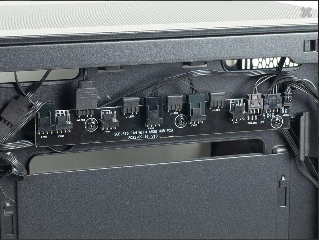

bikeman25 Posted May 29, 2025 Share Posted May 29, 2025 Hello All Desktop Case is a Lian Li Lancool 216 ARGB Case with Included ARGB & Fan Hub inside the system. Wondering for next dust clean out coming up soon, if anyone knows which fan port my 2 160MM front fans should be plugged into to be able to control them in UEFi bios for Fan curves and such. ((I'm a kinda still newbie with Hardware, but trying to learn slowly)) Seems i don't have a picture of mine currently on my phone, i thought i did, but i guess i don't at the moment, and way desk is, can't get to that side of the PC case right now ((this forums always been helpful more so than Reddit)) so decided to ask here lol, versus asking on a Reddit area lol Generic Picture from Bing Images of the Lian Li Lancool 216 ARGB & Fan hub Link to comment https://www.neowin.net/forum/topic/1455258-lian-li-lancool-216-argb-fan-hub-question/ Share on other sites More sharing options...

Jim K Global Moderator Posted May 30, 2025 Global Moderator Share Posted May 30, 2025 Doesn't matter where you connect your fans ... Fan 1, Fan 2, Fan 6, etc....doesn't matter one bit. All fans on that hub will run at the speed of whatever motherboard fan header you've plugged it into. That first four pin (on the right) is your power (4-pin --> SATA). The connector left of it goes to your motherboard fan header. The correct cables and manual should have come with the case? WaltC 1 Share Link to comment https://www.neowin.net/forum/topic/1455258-lian-li-lancool-216-argb-fan-hub-question/#findComment-598990503 Share on other sites More sharing options...

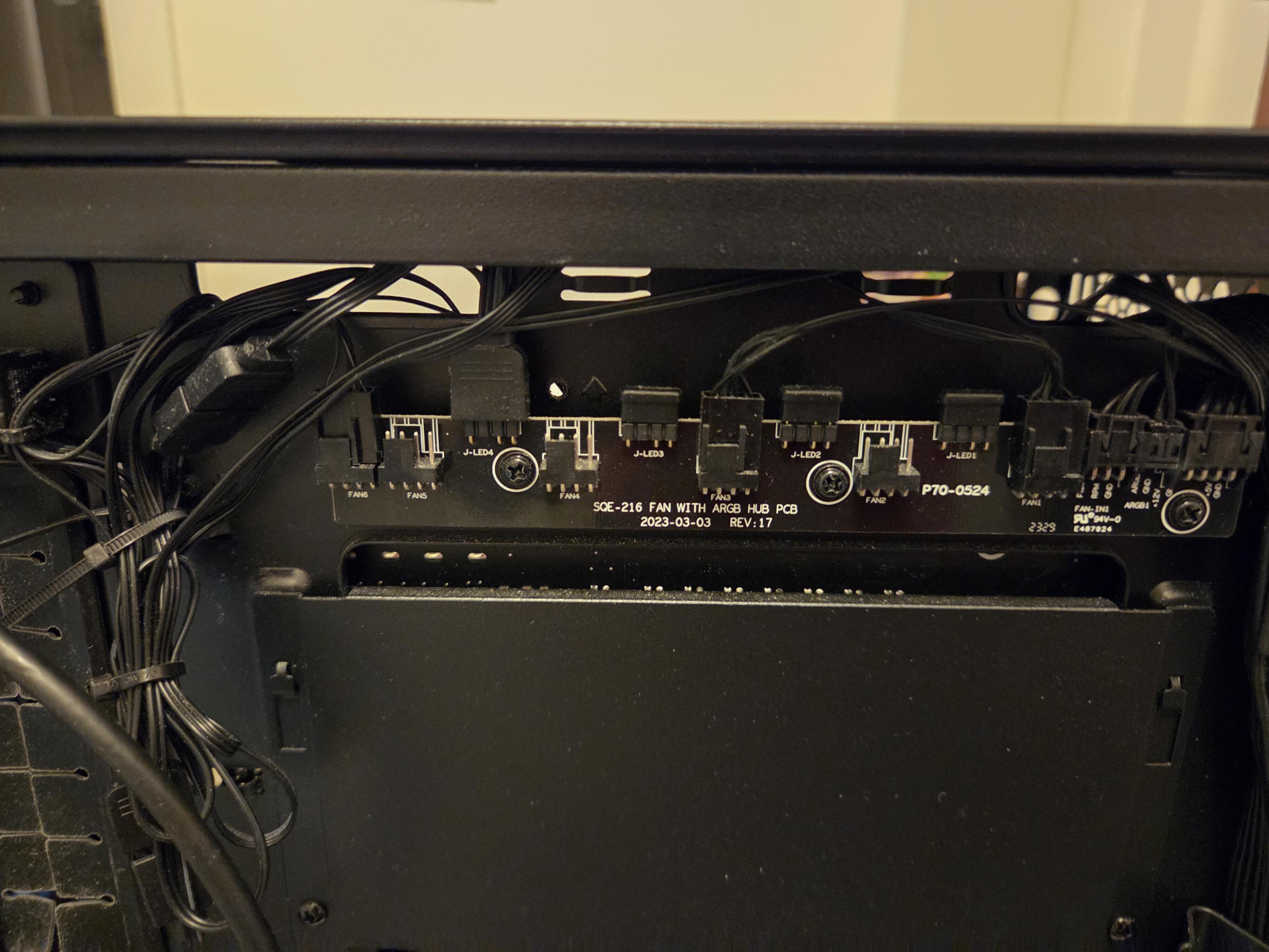

WaltC Posted November 28, 2025 Share Posted November 28, 2025 I've been running Argus Monitor for a few years now, and it just so happens that two years ago, Black Friday (heh..;)), I bought a Lian-Li LanCool 216 myself, on sale, and when I got it out of the box I noticed it included the ARGB panel, gratis, which was fine with me. I'm not into light shows, but I disconnected each fan from the ARGB panel (panel as shown in your screenshots), and then connected them to whatever 4-pin mboard fan connectors I wanted directly. And as Argus Monitor supports a number of old and new motherboards, it gave me immediate control of the case fans. I agree that the stock fans are effective and nearly silent! Just thought I'd suggest it as we have the same case...;) Link to comment https://www.neowin.net/forum/topic/1455258-lian-li-lancool-216-argb-fan-hub-question/#findComment-599029566 Share on other sites More sharing options...
