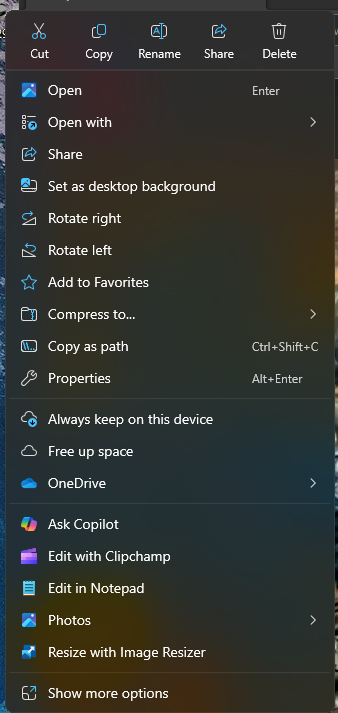

AltecXP Posted July 20, 2025 Share Posted July 20, 2025 Wasnt part of the change in 11 to make the menu smaller? it seems they just keep adding things back. How can I remove any of it? +Nik Louch 1 Share Link to comment https://www.neowin.net/forum/topic/1457001-how-can-i-remove-some-of-this-right-click-menu-crap/ Share on other sites More sharing options...
strotee Posted July 20, 2025 Share Posted July 20, 2025 (edited) Windows Registry Editor Version 5.00 [HKEY_CURRENT_USER\Software\Microsoft\Windows\CurrentVersion\Shell Extensions\Blocked] "{e2bf9676-5f8f-435c-97eb-11607a5bedf7}"="Share" [HKEY_LOCAL_MACHINE\SOFTWARE\Microsoft\Windows\CurrentVersion\Shell Extensions\Blocked] "{e2bf9676-5f8f-435c-97eb-11607a5bedf7}"="Share" [-HKEY_CLASSES_ROOT\*\shellex\ContextMenuHandlers\ModernSharing] Remove that Share text. AltecXP and goretsky 2 Share Link to comment https://www.neowin.net/forum/topic/1457001-how-can-i-remove-some-of-this-right-click-menu-crap/#findComment-599001848 Share on other sites More sharing options...
xMorpheousx416 Posted July 20, 2025 Share Posted July 20, 2025 https://www.windowsdigitals.com/how-to-remove-items-from-right-click-menu-in-windows-11/ AltecXP and goretsky 2 Share Link to comment https://www.neowin.net/forum/topic/1457001-how-can-i-remove-some-of-this-right-click-menu-crap/#findComment-599001852 Share on other sites More sharing options...
