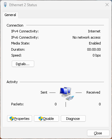

Can you show a screenshot of the Details button?

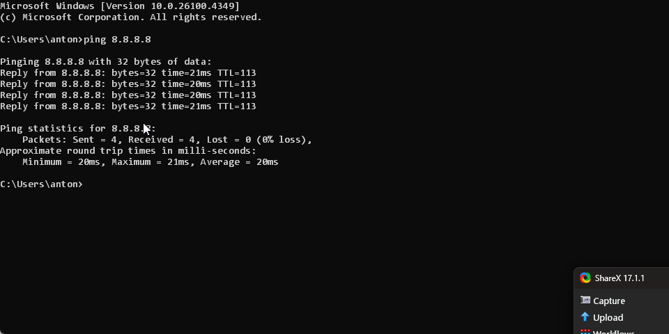

Also, if you open the Command Prompt (press the Windows key on your keyboard and type "cmd") and then write "ping 8.8.8.8" what does it come back with?

Well that's interesting...so you're able to ping Google and get feedback, but Windows isn't reporting the packets sent and received.
To be fair, this is the reason why I haven't been into the control panel for a long time. The GUI says there is nothing going on, but the terminal says otherwise...
I assume that you are writing from the PC in question? Which would mean that you do have an Internet connection, despite what the Windows GUI says.

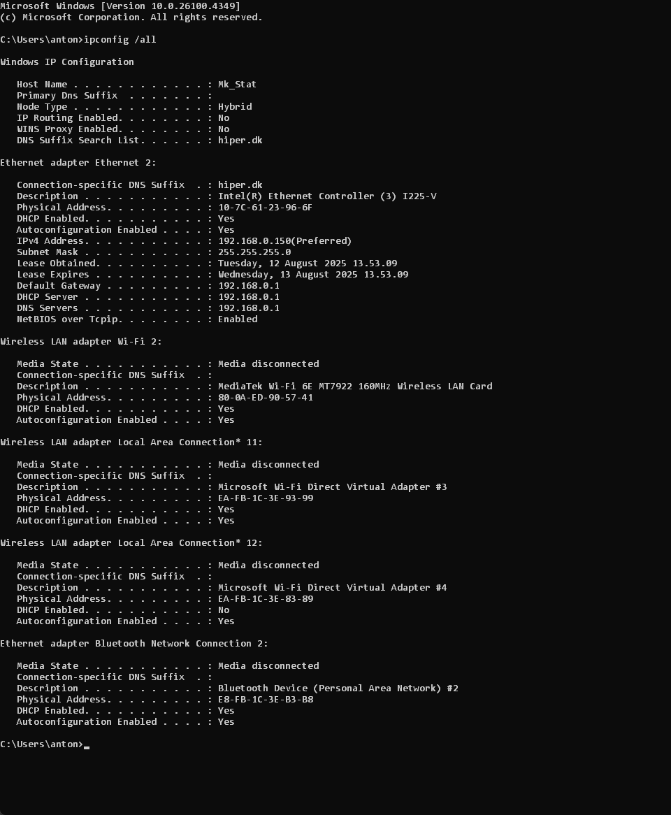

I've also just noticed that the name of the Ethernet connection is "Ethernet 2." Does that mean that there is Ethernet 1 somewhere on the machine?
On 12/08/2025 at 14:20, bogo24dk said:
My comp likes the 2. There is no other network connection that is connected.
Well that's funny. Not "ha ha" funny, just...weird.

  • Windows reports no packets sent/received
  • You know that there have been packets sent and received
  • You've reinstalled the hardware
  • Windows reports the same thing

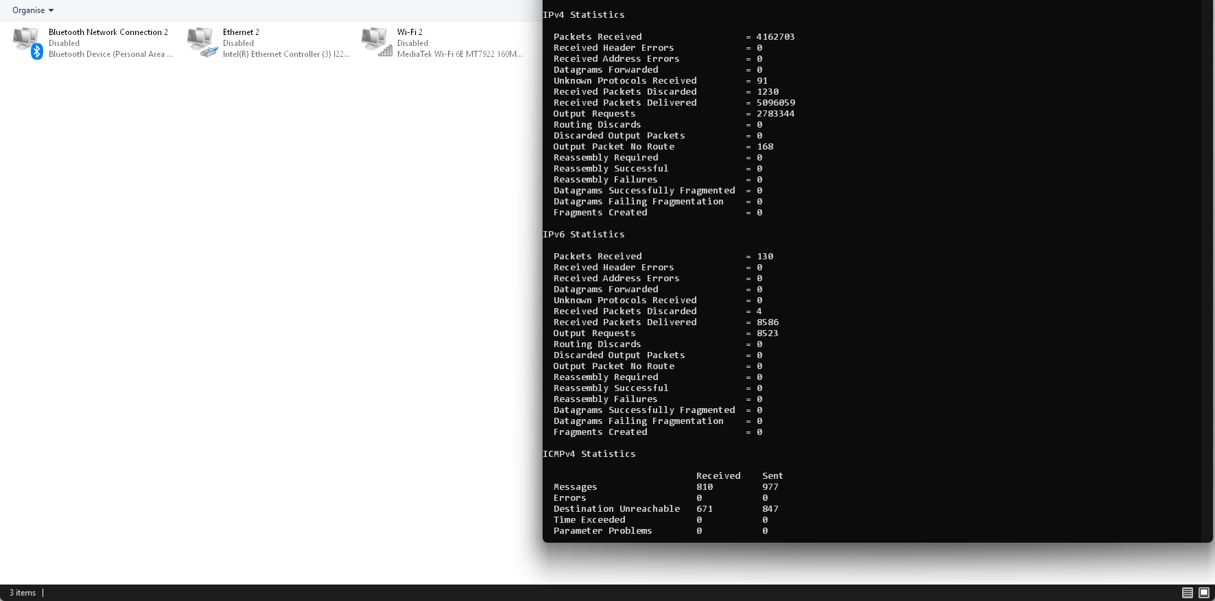

Two more ideas that I have just found for you that helped others:
  1. Disable the WiFi connection and see if the Ethernet starts reporting the packets
  2. Reset the Network Adapter settings: Settings (rather than Control Panel) > Network And Internet > Advanced Network Settings > Network Reset
There is only one adapter that is connected to any source. I went into device manager before in hopes of removing and reinstalling the network card. Will resolve the issue. As you can see, I am on the net to try to figure out why it doesn't work. I have, even today, went to download the latest network card drivers in order to update and restart. In hopes that it will solve the issue.
That's fine, but you want to make sure that you disable the other connections:
Disable any connections that you aren't using and let me know if the connection you are using reports packets or not.

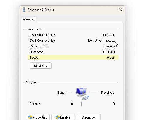

So internet works - but you don't show any sent/recv - this is also odd there its not showing your connection speed
From a cmd prompt - does this show anything?
 wmic NIC where NetEnabled=true get Name, Speed
Name                                      Speed
Killer E2600 Gigabit Ethernet Controller  1000000000
Realtek PCIe 5GbE Family Controller       5000000000
Does a netstat -s showing anything?
 netstat -s

I would have to guess something wrong with the driver.. I would prob uninstall the driver and reinstall it.. But clearly something not right not showing the speed of the interface, or amount of traffic moved..

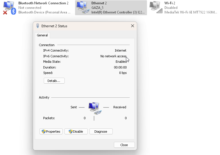

Ok. How can you disable the network card and have the status displayed?
Oh sorry. I meant that you should try disabling any connections that you are not using (WiFi, for example). Apparently there is an occasional bug that means the GUI reports no packets because other connections aren't sending/receiving packets, so if you disable the connections that aren't being used your main connection might start reporting.
Otherwise as I said, there is the network reset option in Windows:
People have mentioned that this can reset the card's optics and start providing the results you're looking for.
What suffix the interface is set for would have zero to do with the speed the interface is connected at, or how many packets have been sent or received.
I would completely remove the interface and re-installed.
What driver are you using for the interface?
