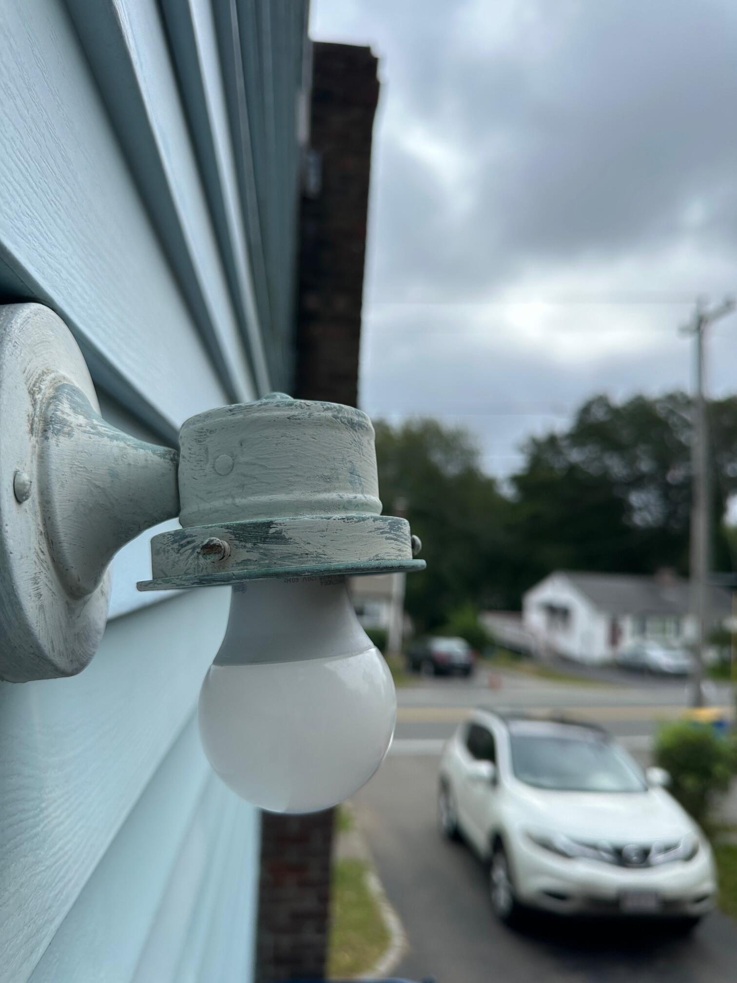

It looks like you will have to back out the screws. There may be three or four. Since it looks like the light itself is corroded. It may take some effort to back them out. I'd recommend using WD-40 to loosen them and clean the rust off of them. This is to prevent the screws from breaking off. Use a pair of pliers to back the screws out. Or use a flat-head screwdriver. Fit the globe into the light fixture socket. Tighten down the screws with your thumbs. Don't use the pliers to tighten the screws down. If using the flat-head screwdriver, torque them down. They don't have to be too tight. Just enough to hold the globe into the light fixture to prevent the globe from falling out of the light fixture. You may use too much force! Be careful not to overtighten them or you will crack and even shatter the globe.
Edited by NeoFyle
thx but like i said the light fixture and globe neck ARE THE EXACT SAME SIZE so u cant do that. Thx though.
