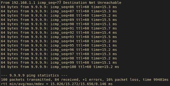

I first noticed it because we do most of our phone calls with Signal, which of course uses data.  He, most of the time, keeps a VPN connection back thru his house enabled on his phone, which forces his phone behind the PiHole, which has the effect of blocking ads for him on his phone even when he isn't home.  However, if his VPN is enabled, about once a minute I noticed all audio would drop for 5-10 seconds.  I also noticed that, when logging in via SSH to do any kind of maintenance (via the the VPN connection), that sometimes it'll just stop responding for 5-10 seconds and then everything I typed during that period will appear all at once.  To rule out the possibility of the issue being the VPN service I did some ping tests to the Cloudflare DNS servers (1.1.1.1), the Quad9 DNS server (9.9.9.9) and his own router from the mini PC itself instead of from my own machine via the VPN connection.  Pings to his own router always work fine.  Pings to anything outside his home though will, inevitably, have some amount of dropped packets.  The issue does not affect his router or any other wired device in the house.  Only this new mini PC seems affected.

At the same time though, I'm not completely convinced it isn't an issue with the router, except we've tried using different cables, different ports on the router, etc., and no other wired device is affected.  Only his PiHole/PiVPN server.
I'm just really at a loss for why, once a minute or so, it just starts dropping packets for a few seconds, then picks right back up like nothing was wrong.
