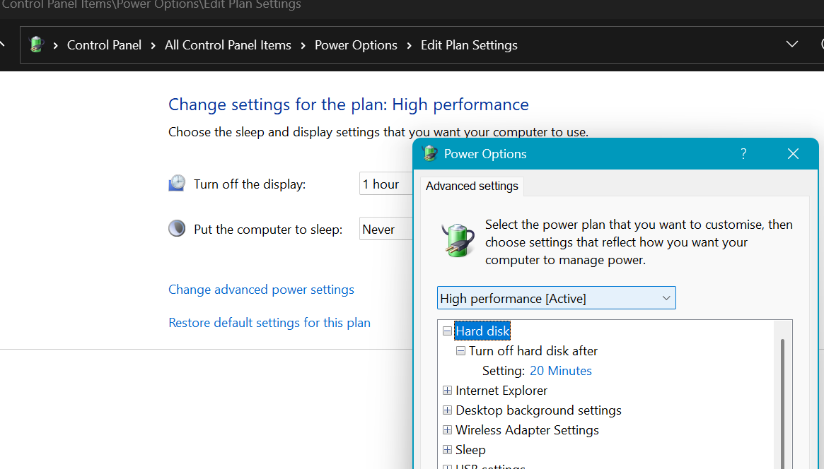

Are you looking at the power options via control panel or the win 11 settings?
Have got a very similar build and have 2x WD connected which mostly stay powered off. Have got them set to 20 minutes, can't see anything in Win11 setting around this.

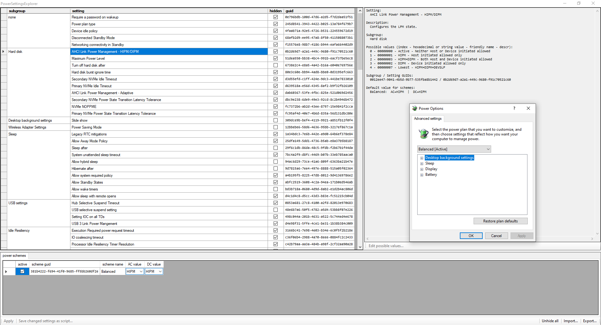

Just in case, because I've seen Windows hide power settings through its UIs over the years, check with PowerSettingsExplorer (or through the Registry) the configuration for the power management of AHCI links, perhaps you want it to be HIPM+DIPM if it's not already, and the disks' APM enabled with standby.
Windows 10 here, but most power related settings aren't visible on my laptop:
