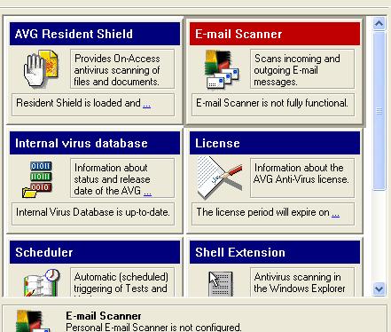

Goodevening everyone,
I was just wondering if someone could help me out with setting up my AVG 7 to work with emails i recieve with Outlook 2003. I have the latest version of AVG and on the 'Control Center' of the program, it states that "Email Scanner Is Not Fully Functional". What do i need to make it be functional?
When i click on Activate for the E-mail scanner, it comes up with the Email Application Selection screen but only shows Outlook Express 4, 5 and 6. But no Outlook 2003
Can anyone help?
Thank you for your help and time
Alex

Download the latest version from www.grisoft.com and then run the installer and select to add componets (not remove, etc). Then add the email scanner and the MS Outlook plugin. The MS Outlook plugin will work out of the box so to speak however you will need to setup the email scanner which is a proxy between your Outlook and your mail server. So you set your servers (both POP and SMTP) to 127.0.0.1 and the ports you specify. Your mail will then be checked when you send/receive it as it will automatically go through AVG and be scanned.
Technically you don't need both plugins installed but it won't hurt doing it. PM or MSN (I would prefer MSN) me if you need any help.

Alex_is_Axel what options do you have in AVGs drop down list for email plugins?
If you have just the AVG MS Outlook Extenstion then it should work no problem. It can't not work really as it is just an extension that Outlook loads. If you have "Personal E-mail Scanner" installed and not setup then it will be reporting an error and that is why you will get the red error . On all the installed plugins click the "Ignore plugin status" check box so that it reports no errors, then untick it for one plugin and check the status, keep doing that until you get the error again and then you know which plugin(s) are causing problems.
