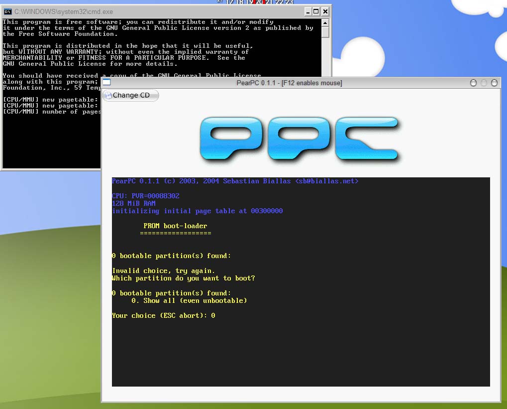

i didn't want to hijack another pearpc threadso i'm making one for myself. i'm new to pearpc, just downloaded pearpc-0.1.1-win32-jitc. yesterday i got mac osx panther 10.3 from my dear mac friend. now how do i go about setting up pearpc etc? i have absolutely NO clue. the website didn't help me very much either. please help me.

that's how it's setup by default. yea. now what? i have the isos. the path is correct etc. can't boot. that's the only problem.

do this:
Go into your config file and change the "prom_env_machargs" to read "-s". Thats SMALL s, not capital s. Obviously if the line is commented out, remove the # so it works. Boot the machine from the CD again as before. This eventually leaves you with the shell/command prompt, and we're about to tackle the job that Darwin would've been used for if it were needed. Type "pdisk" to start the partition tool.
1. Type "e" (without quote marks) then hit enter.
2. For name of device enter "/dev/disk0". Again, no quote marks.
3. Press "p" to view the partition table. The 3rd one actually needs to be moved up to 2 to make it bootable. So...
4. Press "r" to go into partition reordering mode.
5. Enter the number of that partition (3).
6. Enter 2 to move it to the second position.
7. Hit w to write the partition table, check it using p again if you want to confirm it is all okay.
8. Hit q to quit, then hit it again.q. Type reboot which will close PearPC.
9. Go into the config file and comment out the "prom_env_machargs", which will leave the standard mac bootup screen rather than the verbose mode when you now restart PearPC.
10. You should now see the hard drive partition listed as bootable - yay! And, because you set the bootmode to "select" right at the start, you can just select it to boot OS X without having to comment out the cd drive, which also lets you access the cd drive from within OS X. So go ahead and boot it. One thing I would advise first off is to go into the system preferences>energy saving/power management section and TURN OFF SLEEP MODE... this prevents it from crashing every so often when left. There you go, Panther in 20 steps!
got all this from here: http://www.emaculation.com/phpBB/viewtopic.php?t=1102
