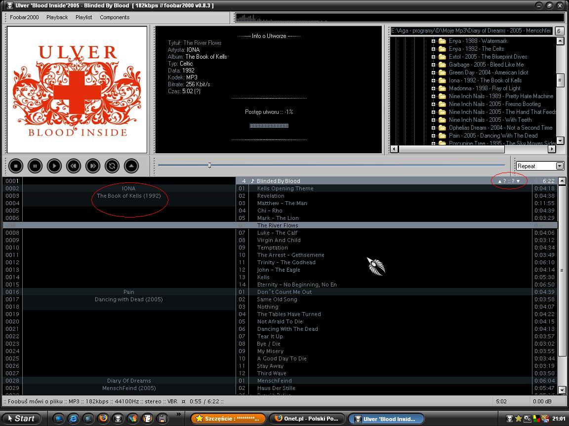

Dorian Posted July 27, 2005 Share Posted July 27, 2005 Hello I have such question. How can I manage to get further info on my playlist under "the band name" and "album name" ... what should I add to foobar's strings to get an info on " genre of an album"and "release date" ? I pointed out with a red circle of which area I'm talking about. And I attached fcs file in zip if someone could look in it and add some strings in it , I would be very thankfull. Thanks in advance!!! moja.zip Link to comment Share on other sites More sharing options...
Krpano Posted July 27, 2005 Share Posted July 27, 2005 ^ i think the best way to find how to do it is to dl some fcs that already have all those infos. Take a look into Soap or Azrael fcs, then just copy the parts you want. For ex. mine is based on SOAP fcs and the Artist/Album collumn(not for singles)area has these strings. $if(%_xsingle%, $if(%artist%,$tab()$if(%_isplaying%,737373|737373,737373|737373)%artist%), $select($min(%tracknumber%,5), // --- 01 --- $if(%_xvarious%,$if3(%album artist%,%performer%,Various Artists),[%artist%]), // --- 02 --- $if(%album%,%album%[ CD$num(%disc%,1)]) $if(%discname%,BEBEBE|BEBEBE' ('%discname%')'), // --- 03 --- [%date%$if(%genre%, • )][%genre%], // --- 04 --- $if($stricmp($left(%_path_raw%,7),'file://'),$upper($ext(%_path%)), $if($stricmp($left(%_path_raw%,7),'cdda://'),CD Audio, $if($stricmp($left(%_path_raw%,7),'http://'),HTTP '('$codec()')'))) ' [' $if($or( $stricmp($codec(),FLAC), $stricmp($codec(),Monkey''s Audio), $stricmp($codec(),OptimFROG), $stricmp($codec(),WavPack), $stricmp($codec(),Windows Media Audio V9 '('Lossless Mode')'), $stricmp($codec(),Shorten)), $muldiv(%__bitrate%,100,1411%)'%', $if($stricmp($codec(),True Audio),'('$right(%__compression%,2)'%', $if($stricmp($codec(),MP3),$if(%__extrainfo%,'~')) $if2(%__bitrate_dynamic%,%__bitrate%) kbps)) $if($stricmp($codec(),Monkey''s Audio), %__compression%) ']' )) About the red circle you have on the right side. If i understand what you want to do there, you have to enable dynamic info in playlist. Its under Options > Display. Hoe this helps. Link to comment Share on other sites More sharing options...
Dorian Posted July 27, 2005 Share Posted July 27, 2005 ^ i think the best way to find how to do it is to dl some fcs that already have all those infos.I must figure it out and just like You told me - I'll take several strings from Azrael About the red circle you have on the right side. If i understand what you want to do there, you have to enable dynamic info in playlist. Its under Options > Display. That's it:)!!! Hoe this helps. 586282112[/snapback] Krpano - Thanks a lot!!! Link to comment Share on other sites More sharing options...
